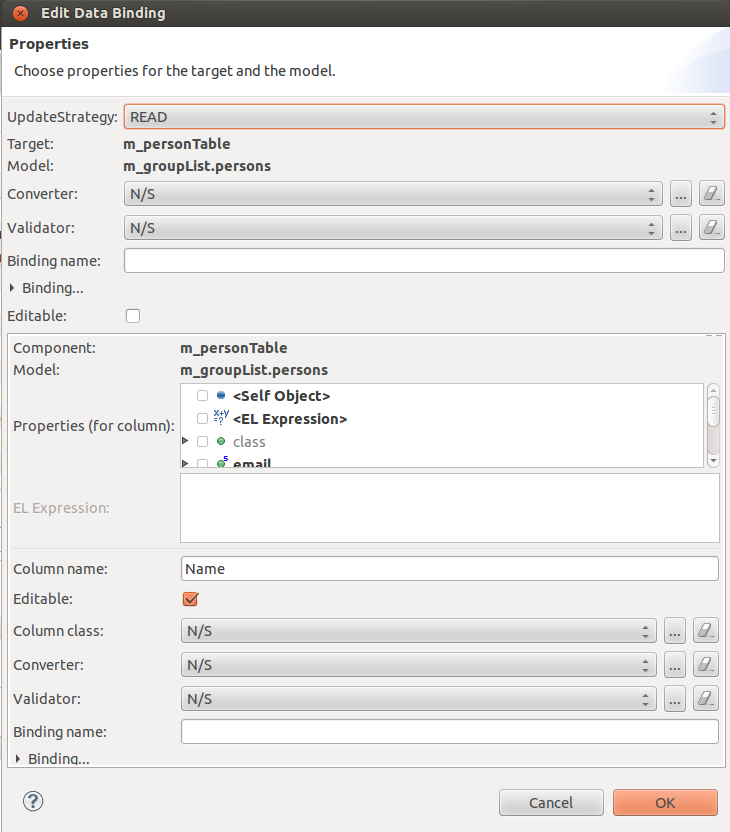

I am building a Swing application using WindowBuilder for the first time (I am impressed so far), but I am facing a problem when using JTable data binding.
What happens is that the data binding wizard for the table is not displaying the tabs and the option for adding column binding details.
To troubleshoot this, I downloaded the Swing phone book example from:
developers.google.com/java-dev-tools/wbpro/features/swing/data_binding/example
but the same issue occurs.
In this case the column bindings already exist, but the tabs to cycle different columns, and the "Add" option do not show up.
I have attached a screenshot that shows the issue.
This occurs in two different OSs (One is a Linux Mint 15 - 64 bit, and the other is an Ubuntu 12.04 - 32 bit) but with the same dev config:
Eclipse Kepler
WindowBuilder 1.6.0
beansbinding-1.2.1.jar
Do you know what might be causing this ?

Re: Problem in Swing JTable column binding wizard - no tabs [message #1170121 is a reply to message #1076100] Mon, 04 November 2013 07:22 Go to previous messageGo to next message
3. Anyone seeing the same problem ?
yes, i have the same problem Sad
Re: Problem in Swing JTable column binding wizard - no tabs [message #1203687 is a reply to message #1076100] Fri, 22 November 2013 14:53 Go to previous messageGo to next message
Chris Morgan wrote on Tue, 30 July 2013 14:01
I have the same problem too.
Is there any solution?
Re: Problem in Swing JTable column binding wizard - no tabs [message #1204023 is a reply to message #1203687] Fri, 22 November 2013 18:47 Go to previous message
Hi.
I have posted this issue in bugzilla. You can follow it here: https://bugs.eclipse.org/bugs/show_bug.cgi?id=417189
