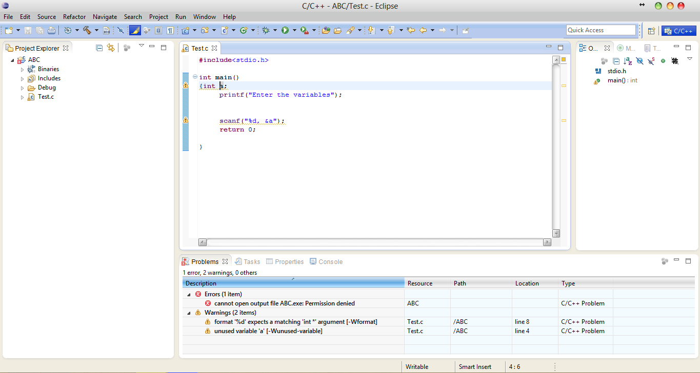

I am using eclipse-JUNO
I have installed MinGW and configured it perfectly to run with eclipse
The Hello World program works fine
But anything else then that it gives me a error saying:
cannot open output file ABC.exe: Permission denied
  • Attachment: Capture.PNG
    (Size: 76.33KB, Downloaded 154 times)

Best to ask about C related things on the CDT forum. Though it sounds
to me like perhaps you've run it once and then it's still running so the
exe is locked and can't be removed or updated; you might check the task
manager to see that the process is not still running and you might try
deleting it with the window's explorer.
