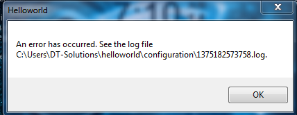

My scout aplication run so well, exceptly when i do a deploy.
Iam using Tomtac 7.
eclipse kepler.
inside the browser, the only thing that can see is the page where i am able to download the client aplication.
the problem continue if i use de client aplication. see the image ...
this is the message in the log file.
"!ENTRY org.eclipse.equinox.app 0 0 2013-07-30 01:31:01.747
!MESSAGE Product org.eclipse.helloworld.ui.swt.product could not be found."
i let the log file attached.
I appreciate your help.

can you show the contents of the WEB_INF/eclipse/configuration/config.ini as well as the plugin and folder names that are in the WEB_INF/eclipse/plugins Folder.
In Windows you can therefore simply go to command window (CMD) and type
dir /b C:/path-to-tomcat/webapps/your-app/WEB-INF/eclipse/plugins
and the past the result into this forum post.
Most likely there is a missing launcher bundle or a missing update.configuration bundle.
The log talks about such missing dependency.

Re: Desktop aplication and web aplication. [message #1076013 is a reply to message #1075955] Tue, 30 July 2013 10:17 Go to previous messageGo to next message
Thanks, the serverside looks great.
Can you give me config.ini and dir /B also for the Client/Gui side?
I assume you are using SWT?
Did you export the following product or which one was it?
/org.eclipse.helloworld.ui.swt/products/production/helloworld-swt-client.product

Re: Desktop aplication and web aplication. [message #1079052 is a reply to message #1076046] Sat, 03 August 2013 21:03 Go to previous messageGo to next message
well. thanks everybody who helped me in this thread.
I got a solutions, I had to changing the whole eclipse project, i downloaded the eclipse scout solutions, and when i deploy my aplication, everything is ok.
thanks.
