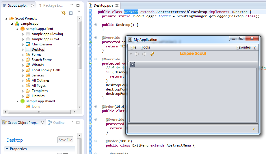

Re: scout - 3.9 - desktop node not showing [message #1075270 is a reply to message #1074734] Mon, 29 July 2013 02:41 Go to previous messageGo to next message
Can you provide more informations about your setting?
I have tried with 3.9.0.20130612-0904 (default version that is provided on the download page eclipse-scout-kepler-R-win32)
I have created a new application with a single form.
I see the Desktop node.
index.php/fa/15739/0/
This makes sense, because menus can be added to the desktop even in a "single form application".
Can you browse to the Java class with CTRL-Shift-T > "Desktop"?
What is your version?
Is this an old project (created with Juno) that you try to open with Kepler?
  • Attachment: Desktop.png
    (Size: 78.16KB, Downloaded 952 times)
[Updated on: Mon, 29 July 2013 02:43] by Moderator

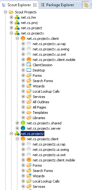

Re: scout - 3.9 - desktop node not showing [message #1075290 is a reply to message #1075270] Mon, 29 July 2013 03:31 Go to previous messageGo to next message
These were new projects created with kepler version of scout (3.9.0-20130612-0904).
I could see the Desktop files in the package view, even though the Desktop Nodes weren't showing in the scout view.
The Desktop node have become available after restarting eclipse.
I just created a new project (projectz) - and again no desktop:
index.php/fa/15741/0/
There is nothing reported in the eclipse .log file to indicate an error:
!SESSION 2013-07-29 08:16:38.464 -----------------------------------------------
eclipse.buildId=4.3.0.I20130605-2000
java.version=1.6.0_25
java.vendor=Sun Microsystems Inc.
BootLoader constants: OS=win32, ARCH=x86_64, WS=win32, NL=en_GB
Framework arguments:  -product org.eclipse.epp.package.scout.product
Command-line arguments:  -os win32 -ws win32 -arch x86_64 -product org.eclipse.epp.package.scout.product
!ENTRY org.eclipse.scout.sdk 1 0 2013-07-29 08:16:48.243
!MESSAGE org.eclipse.osgi.framework.internal.core.BundleContextImpl$1.run(BundleContextImpl.java:711)
	Starting SCOUT SDK Plugin.
!ENTRY org.eclipse.egit.ui 2 0 2013-07-29 08:18:44.333
!MESSAGE Warning: The environment variable HOME is not set. The following directory will be used to store the Git
user global configuration and to define the default location to store repositories: 'C:\Users\snowc'. If this is
not correct please set the HOME environment variable and restart Eclipse. Otherwise Git for Windows and
EGit might behave differently since they see different configuration options.
This warning can be switched off on the Team > Git > Confirmations and Warnings preference page.
  • Attachment: nodesktop.png
    (Size: 21.35KB, Downloaded 767 times)
[Updated on: Mon, 29 July 2013 03:33] by Moderator
