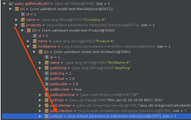

I am using the criteria below:
CriteriaBuilder criteriaBuilder = em.getCriteriaBuilder();
CriteriaQuery<Manufacturer> criteriaQuery = criteriaBuilder.createQuery(Manufacturer.class);
criteriaQuery.distinct(true);
Root<Manufacturer> mainRoot = criteriaQuery.from(Manufacturer.class);
Join joinProducts = mainRoot.join("products", JoinType.INNER);
Path<NickName> nickNames = joinProducts.get("nickNames");
Predicate noEmptyList = criteriaBuilder.isEmpty(nickNames.get("justList"));
// or if I use nickNames.get("justList").as(List.class) is the same result
criteriaQuery.where(criteriaBuilder.and(noEmptyList));
TypedQuery<Manufacturer> query = em.createQuery(criteriaQuery);
query.getResultList().size()// check the screen to see the result
but... that is not working. It is bringing me a result with not empty "justList", but in the code I added the predicated "criteriaBuilder.isEmpty".
In the screen it is possible to see a wrong result.
index.php/fa/15729/0/
PS.: The same criteria works with Hibernate and OpenJPA. =/
PS2.: The created query is:

Just now I noticed that there is a bug opened for this: https://bugs.eclipse.org/bugs/show_bug.cgi?id=386354
And the bug was reported by me. Embarrassed
Sorry, it was so long ago that I could not remember it. -_-''
If you guys could vote for it, I would be happy! Very Happy

What EclipseLink versions have you tried this against? Are you been able to run against 2.5 or a 2.6 nightly to verify the SQL is still the same?
icon10.gif  Re: Problem with criteria [message #1075790 is a reply to message #1075448] Tue, 30 July 2013 00:24 Go to previous message
Hello Chris,
Thanks for the response, I tested with version 2.5.0: http://mvnrepository.com/artifact/org.eclipse.persistence/org.eclipse.persistence.jpa/2.5.0 and...
The problem is solved! \o/
Yeeeey! I have to use a version already released to test with my framework (EasyCriteria - http://easycriteria.uaihebert.com).
Thanks for your feedback.
I will update the opened issue.
