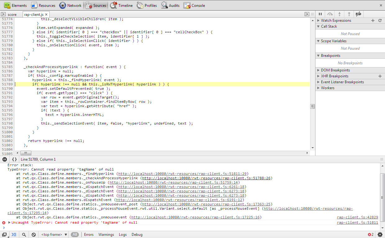

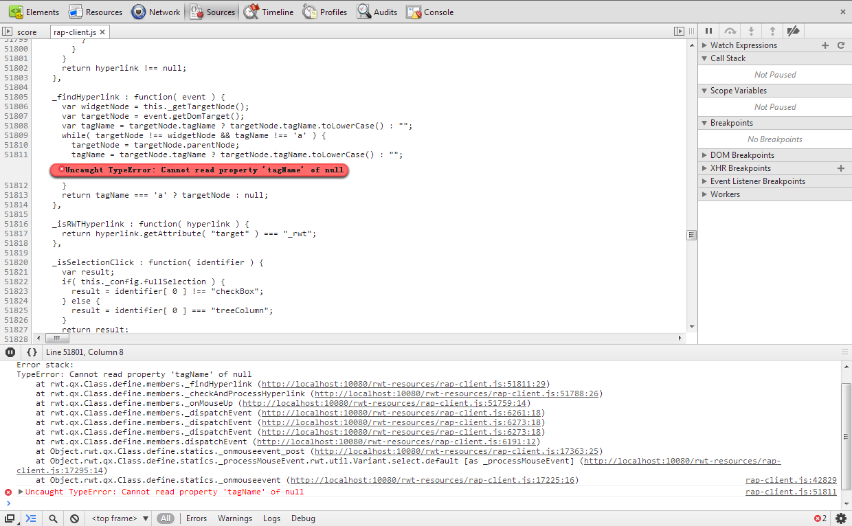

now, when I scroll the table or gird from one side to the other, the error occurs always even in Firefox, Chrome or IE. The code above happens in Firefox, but in Chrome 28 or IE 10 the code is not the same with it in Firefox
in Chrome or IE the code is like below:
Error: TypeError: Cannot call method 'toLowerCase' of undefined
  Stack: TypeError: Cannot call method 'toLowerCase' of undefined
    at rwt.qx.Class.define.members._findHyperlink (http://localhost:10080/rwt-resources/rap-client.js:51811:41)
    at rwt.qx.Class.define.members._checkAndProcessHyperlink (http://localhost:10080/rwt-resources/rap-client.js:51788:26)
    at rwt.qx.Class.define.members._onMouseUp (http://localhost:10080/rwt-resources/rap-client.js:51759:14)
    at rwt.qx.Class.define.members._dispatchEvent (http://localhost:10080/rwt-resources/rap-client.js:6261:18)
    at rwt.qx.Class.define.members._dispatchEvent (http://localhost:10080/rwt-resources/rap-client.js:6273:18)
    at rwt.qx.Class.define.members.dispatchEvent (http://localhost:10080/rwt-resources/rap-client.js:6191:12)
    at Object.rwt.qx.Class.define.statics._onmouseevent_post (http://localhost:10080/rwt-resources/rap-client.js:17363:25)
    at Object.rwt.qx.Class.define.statics._processMouseEvent.rwt.util.Variant.select.default [as _processMouseEvent] (http://localhost:10080/rwt-resources/rap-client.js:17295:14)
    at Object.rwt.qx.Class.define.statics._onmouseevent (http://localhost:10080/rwt-resources/rap-client.js:17225:16)
  Debug: on
[Updated on: Fri, 26 July 2013 03:19] by Moderator

Re: error occurs occasionally when using MARKUP_ENABLED img tag [message #1074519 is a reply to message #1074153] Fri, 26 July 2013 21:34 Go to previous messageGo to next message
Hi Ivan,
I test the newest nightly build rap-2.2.0-N-20130726-1307 just now, but error still happens.
I tested it in firefox, chrome and ie and this happens when I scroll the table or grid.
in firefox:
rror: TypeError: targetNode is null
  stack: .members._findHyperlink@http://localhost:10080/rwt-resources/rap-client.js:51811
.members._checkAndProcessHyperlink@http://localhost:10080/rwt-resources/rap-client.js:51788
.members._onMouseUp@http://localhost:10080/rwt-resources/rap-client.js:51759
.members._dispatchEvent@http://localhost:10080/rwt-resources/rap-client.js:6261

Hi Ivan,
I created a little test project, only one table in it, but it run ok.
I give a screen shot of runing in chrome, hoping it useful for you
index.php/fa/15730/0/
index.php/fa/15731/0/
  • Attachment: 001.png
    (Size: 105.29KB, Downloaded 621 times)
  • Attachment: 002.png
    (Size: 107.94KB, Downloaded 598 times)
Re: error occurs occasionally when using MARKUP_ENABLED img tag [message #1074618 is a reply to message #1074615] Sat, 27 July 2013 04:39 Go to previous messageGo to next message
thanks for the screenshots, but they don't help much. The problem is in
the exact DOM (HTML) elements configuration. That's why I need a test
project to reproduce and trace the issue. I've played a lot with
Table/Tree with different configurations of the markup, but I can't
reproduce the issue in any browser. Fixing something blindly will not
lead to anywhere.
Best,
Ivan
On 7/27/2013 11:30 AM, Song David wrote:
> Hi Ivan,
Ivan Furnadjiev
Twitter: @EclipseRAP
Re: error occurs occasionally when using MARKUP_ENABLED img tag [message #1074628 is a reply to message #1074618] Sat, 27 July 2013 05:15 Go to previous messageGo to next message
Hi Ivan,
The strange thing is that errors happen even before I load data into the table when I scroll the table, I create a example page in org.eclipse.rap.examples.pages projects.
hope it can help.
Best Regards
David
