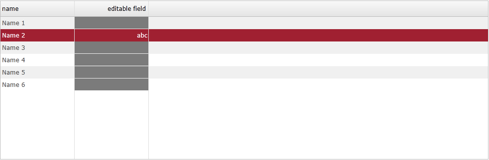

Hello Ivan,
here are three screenshots. In first picture you see an example table with two columns.
index.php/fa/15720/0/

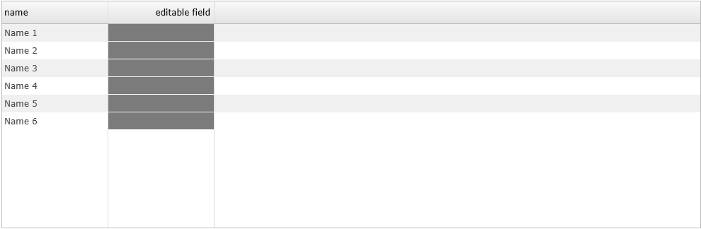

The second column is editable and hast another background color. When i edit this field it changes its color to mouseover (second picture).

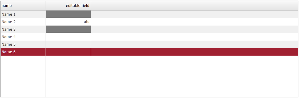

After when i select another cell it changes its color to default color (third picture).
index.php/fa/15722/0/
I set color in ColumnLabelProvider on update event:
table.addEditingColumn("editable field",
				150,
				new ColumnLabelProvider() {
			public void update(ViewerCell cell) {
				super.update(cell);
				DemoObj element = (DemoObj)cell.getElement();
				cell.setText(element.getEditableField());
				cell.setBackground(new Color(Display.getCurrent(), 123, 123,123));
Best Regards,
Christian

Christian,
I looked in your code more carefully and I think that this issue is
invalid. You must override ColumnLabelProvider#getBackground( element ),
ColumnLabelProvider#getText( element ) and not to set them in
ColumnLabelProvider#update method. See ColumnLabelProvider class - the
default implementation of these methods return null.
Best,
Ivan
