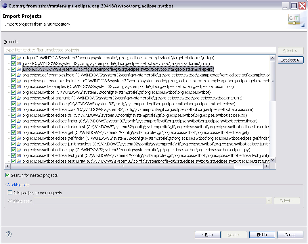

I checked out swtbot from
ssh://<username>@git.eclipse.org:29418/swtbot/org.eclipse.swtbot
and set the keplar Target Platfrom.

(by the way#2: the kepler target platform project has the name juno)
Re: Require-Bundle org.hamcrest [message #1070220 is a reply to message #1070215] Wed, 17 July 2013 09:24 Go to previous messageGo to next message
(by the way#3: there are two target platform projects and in one is nothing https://git.eclipse.org/c/swtbot/org.eclipse.swtbot.git/tree/target-platforms)

Thanks for all these reports.
All of them are actually minor bugs, and your welcome to open a bugzilla
issue and a Gerrit contribution to polish these bundles and target platforms
* empty target-platforms/ folder can be removed
* compile issues happen on projects that are currently not built as part
of SWTBot Tycho build. It might be helpful to fix them
* Environment specification in TP could be removed to have a
platform-agnostic TP
* kepler.target could change label to juno.
