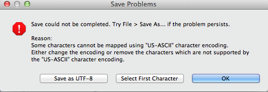

In Kepler, these characters are showing as unknown--the question mark inside the diamond symbol. If I try to save the files, I get a message saying:
index.php/fa/15592/0/
I've tried changing the encoding from ASCII to UTF-8 on my source files, and this doesn't help. If I type the character from the keyboard, it shows in the source file correctly, and displays correctly in my applications. Is there some way to correct this problem, other that finding every instance and inputting the correct character again?

I found out what caused the problem. In Helios, on the Mac, the default text file encoding is Mac Roman. (File > Properties) This is not a file type allowed under Kepler. I still need to know if someone has a quick fix to resolve the issue.

John,
If the file itself is already encoded with Mac Roman, you'll need to
read it with that encoding, then change the encoding, and then save it
(or fix the corrupt characters manually before saving) . Changing the
encoding of an existing file is only helpful for changing it to an
encoding that matches how the bytes are already encoded, i.e., I think
it doesn't convert the file. Note that there are workspace, and project
level settings for the default encoding; the latter is better if you
plan to share the files with others (and using an encoding common across
platforms, such as UTF-8 is also wise). Probably best it so avoid the
problem entirely and escape them...

Ed,
Thank you. I used your suggested approach, and it worked well. A key point was that the text encoding selection does not convert the file.
John
