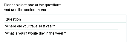

I use an HtmlField on top of my form. It works nice with Swing (I am not sure of the behaviour with SWT).
Notice that you can also use basic HTML in the LabelField with Swing (this produces multiline text). This do not work with SWT.
@Order(10.0)
public class InfoField extends AbstractLabelField {
  protected int getConfiguredGridW() {
    return 2;
  protected int getConfiguredGridH() {
    return 2;
  protected boolean getConfiguredLabelVisible() {
    return false;
  protected void execInitField() throws ProcessingException {
    setValue("<html>Please <b>select</b> one of the questions.<br>And use the context menu.</html>");
