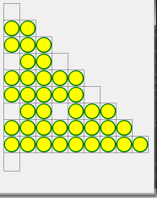

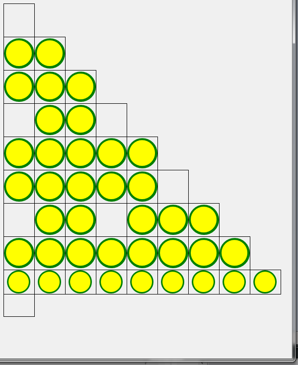

I've been having a problem where the last row in a GridLayout gets squished when re-sizing the shell. Source code excerpt is below the following description.
What I am trying to do is display a rectangular (square, actually) grid of figures. This works well except for the last row, which is fine when my application starts, but after re-sizing the shell, the last row tends to become smaller than the other rows in the grid. Even if you restore the dimensions of the shell to the original size, the last row remains squeezed.
My excerpt below is basically creating a square grid (in this case, one-eighth of a larger grid). Creating a grid

I have also attached pictures of the UI before and after re-sizing the shell.
Any clue how to keep the last row the same size as the others? Also, are there better alternatives to using a GridLayout manager to lay out an evenly-spaced grid? I thought about using an XYLayout, but I'm being lazy here. Smile
Thanks!!!
Before resizing:
index.php/fa/15563/0/
After resizing:
index.php/fa/15564/0/

Well, I just figured out a solution after slapping together a SSCCE as requested.
It turns out that with a GridLayout (in my case, where every cell has a constraint of GridData.FILL_BOTH), the last row and the last column absorb all of the spare space when the spare space is not quite enough to add to the rest of the cells (see my code example below).
For my octant grid (pictures in previous post), I believe the last row looks screwy because it is the only row with a visible cell in the last column, which was somehow messing with the sizes of the rest of the cells in the row. Adding an extra column to absorb the inadequate spare space seemed to fix the problem for me.
Here's the code example that helped me out. If you increase the size of the grid, it makes the last row/column sizing issue more noticeable.
