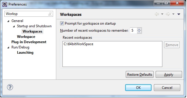

I had the same problem with eclipse kepler in Windows 7. Here is what I did to solve the problem.
Click on Windows --> Preferences --> Search for Workspace --> Check "Prompt for workspace on startup" --> Click Apply ---> Click OK ---> Then File ---> Switch Workspace --> Choose your default Workspace --> Now restart eclipse.
You should be good.

Clement, that solution doesn't work for me. The "Prompt for workspace on startup" box is already checked. That is the default. My guess is that you must have clicked the "Use this as the default and do not ask again" box when prompted to select a workspace. Checking this box unchecks the other one.
If it is working for you I would also guess that you don't have Oracle Weblogic Tools plugin installed. That seems to be causing the problem.
