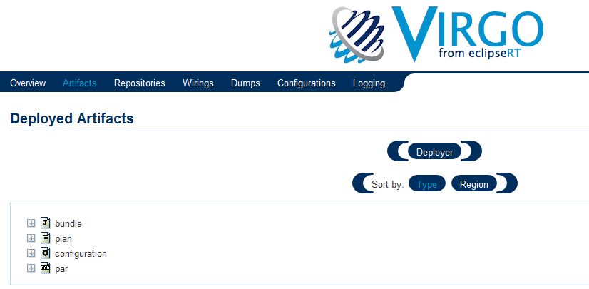

Thanks in advance to anyone who can help.
I'm fairly Eclipse proficient and running VTS on Win 7 for the first time.
BUT... the "Artifacts" page of my admin console does not match the documentation.
I'm logged in as "admin (pw=springsource)"
There is no Browse/Upload bundle option... see attached...
I've performed "Check for Updates", read the user/program/tooling guides, Googled and browsed this forum, ...
Am I missing configuration info? Bundle(s)? etc...?

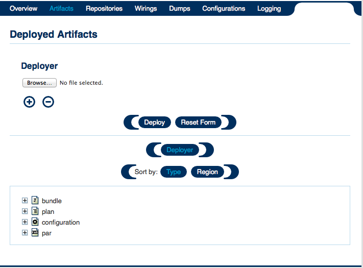

Re: Admin Virgo Console [message #1067420 is a reply to message #1067418] Mon, 08 July 2013 10:54 Go to previous messageGo to next message
Clicking the Deployer button will reveal what you are looking for:
index.php/fa/15516/0/

Re: Admin Virgo Console [message #1067421 is a reply to message #1067405] Mon, 08 July 2013 10:56 Go to previous message
You got it, use the + button to deploy multiple artifacts in the order specified.
