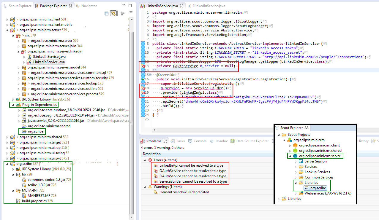

I've created the org.scribe library plugin according to chapter 5.10 and I can both see it in the Scout Explorer as well as the Package Explorer (marked green in the screenshot).
However, I cannot organise the imports to find OAuthService, the content of those two jar files does not seem to be visible.
Are there any additional steps needed except those listed in chapter 5.10 to get access to the scribe libaray?

One difference to the books setup I can see is the organisation of the org.scribe library bundle. Opening the books workspace [1] in the Scout SDK (Kepler Package) displays the commons-codec and the scribe JAR files under folder 'Reference Libraries' (which is missing in your screenshot) in the Eclipse package explorer.
You may want to verify the setup of your version of the org.scribe against the one provided with the book [1].

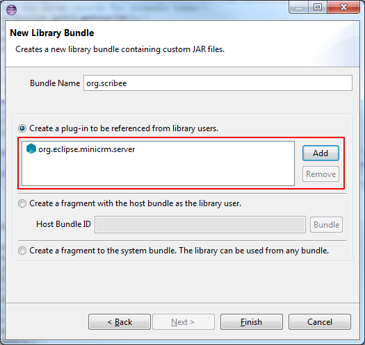

Thanks, I found a few discrepancies:
My .classpath file was missing these two lines:
	<classpathentry exported="true" kind="lib" path="lib/commons-codec-1.8.jar"/>
<classpathentry exported="true" kind="lib" path="lib/scribe-1.3.0.jar"/>
And in my MANIFEST.MF file I had this line
Export-Package: lib
instead of these
Export-Package: org.apache.commons.codec,
 org.apache.commons.codec.binary,
 org.apache.commons.codec.digest,
 org.apache.commons.codec.language,
 org.apache.commons.codec.language.bm,
 org.apache.commons.codec.net,
 org.scribe.builder,
 org.scribe.builder.api,
 org.scribe.exceptions,
 org.scribe.extractors,
 org.scribe.model,
 org.scribe.oauth,
 org.scribe.services,
 org.scribe.utils
I've re-read the instructions on how to create that bundle and I believe that I have followed the instructions that were given to a step. What could be the reason that my files look different? Is there something that I could have done differently when adding this library plugin? Or do the modifications that I now made need to be made manually? In which case that should probably be added to the book?
One difference that I noticed was that the second screen of my Library Bundle Wizard (Fig 5.36) looked slightly different in that it has an additional list and two more buttons:
index.php/fa/15521/0/
Anyway, now that I've updated my classpath and manifest files the project compiles cleanly. However, accessing the OAuth URL fails because I'm behind an authenticating proxy (but I'll open a separate post for this issue).
Thanks for helping me solve this.
