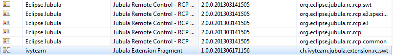

Thanks Achim. And there is the details of above error on server agent:
AUT:09:53:13.447 [Connection.ReaderThread:Socket[addr=AAVN-WS-192.aavn.local/192
.168.72.72,port=51174,localport=51199]] ERROR o.e.j.r.c.c.AbstractCapTestCommand
 - implementation class method not found
AUT:java.lang.NoSuchMethodException: No such accessible method: rcSelectEx() on
object: org.eclipse.jubula.rc.swt.tester.TreeTester
AUT:    at org.apache.commons.beanutils.MethodUtils.invokeMethod(MethodUtils.jav
a:214) ~[org.apache.commons.beanutils.jar:na]
a:162) ~[org.apache.commons.beanutils.jar:na]
AUT:    at org.eclipse.jubula.rc.common.commands.MethodInvoker.invoke(MethodInvo
ker.java:64) ~[org.eclipse.jubula.rc.common.jar:na]
AUT:    at org.eclipse.jubula.rc.common.commands.AbstractCapTestCommand.execute(
AbstractCapTestCommand.java:233) ~[org.eclipse.jubula.rc.common.jar:na]
AUT:    at org.eclipse.jubula.communication.Communicator$ConnectionListener.rece
ived(Communicator.java:844) [org.eclipse.jubula.communication.jar:na]
AUT:    at org.eclipse.jubula.communication.connection.Connection.fireMessageRec
eived(Connection.java:401) [org.eclipse.jubula.communication.jar:na]
AUT:    at org.eclipse.jubula.communication.connection.Connection.access$3(Conne
ction.java:390) [org.eclipse.jubula.communication.jar:na]
AUT:    at org.eclipse.jubula.communication.connection.Connection$ReaderThread.r
un(Connection.java:453) [org.eclipse.jubula.communication.jar:na]
The method rcSelectEx() was implemented in myextension. And at executing test time, I check myextension be installed(attachment image)
Thanks a lot,
Nam
