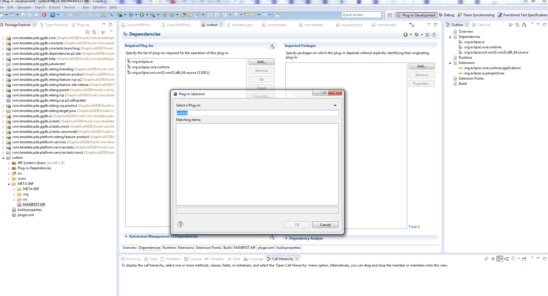

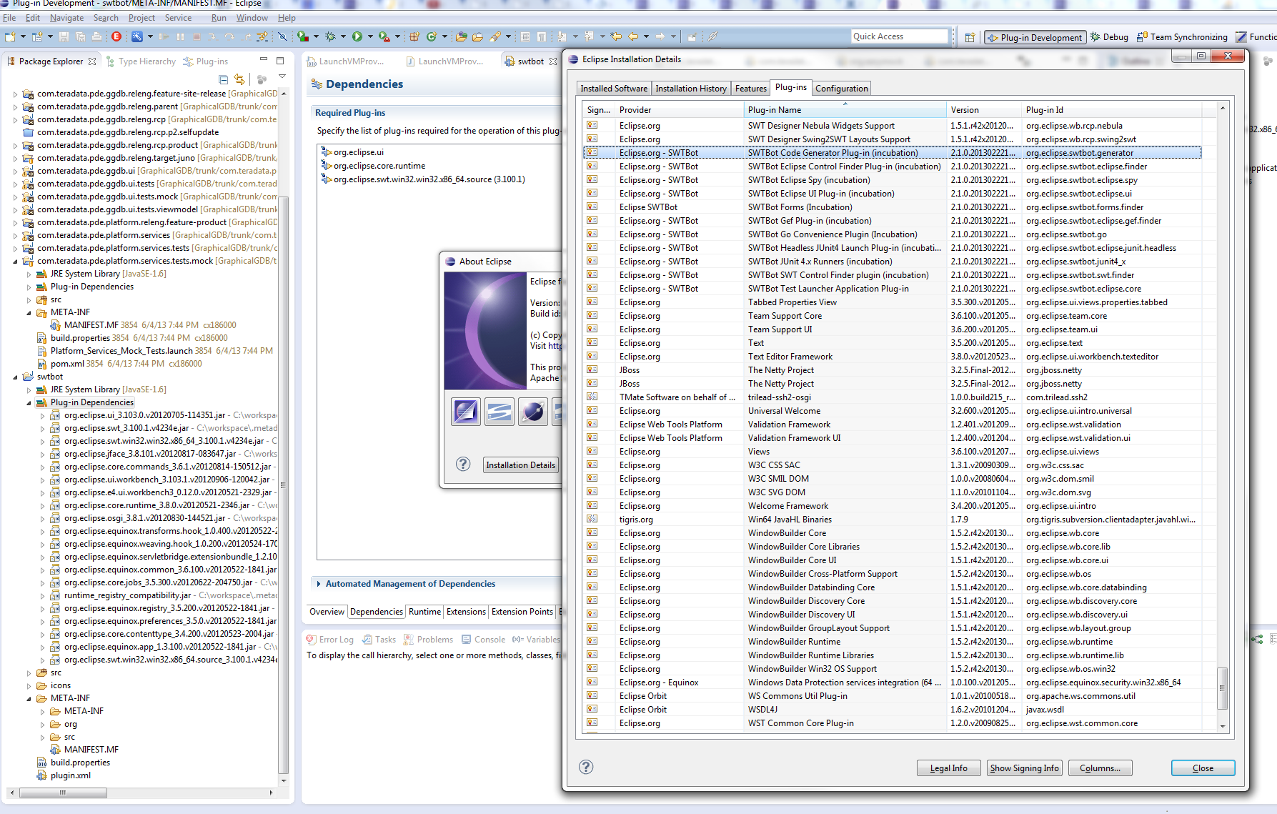

I installed the SWTBOT plugin just the way as tutorial shows. But when I tried to add
org.eclipse.swtbot.eclipse.core
org.eclipse.swtbot.eclipse.finder
org.eclipse.swtbot.junit4_x
org.hamcrest
org.apache.commons.collections
org.junit4
org.apache.log4j
org.eclipse.ui
to the manifest file, it couldn't find it.
I checked with about/installation details. It does show that my eclipse has these plug ins installed though.
When I tried the exact same thing on a fresh new indigo eclipse (the current RCP development eclipse is Juno), it works as expected.
Please help. Screenshots are attached.

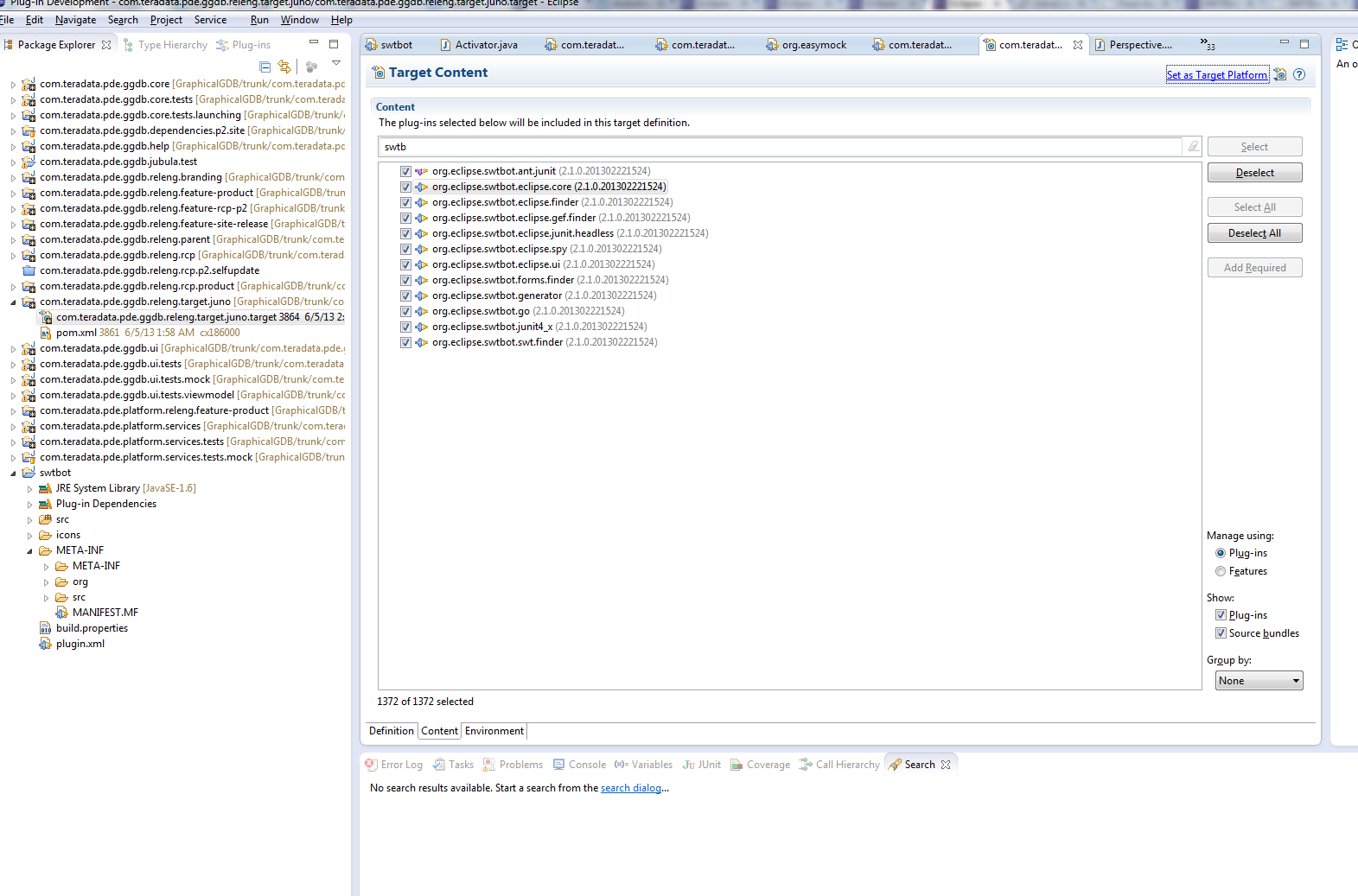

Re: Not able to find swtbot plugin [message #1067443 is a reply to message #1066950] Mon, 08 July 2013 14:02 Go to previous messageGo to next message
I followed the toturial here, http://wiki.eclipse.org/SWTBot/UsersGuide
I made SWTBot plugins available to the target platform, but the manifest file still can't recognize the plugins.
Screenshot is attached.

Re: Not able to find swtbot plugin [message #1067636 is a reply to message #1067443] Tue, 09 July 2013 13:52 Go to previous messageGo to next message
Nevermind. Problem solved. One of the senior engineers corrected the way I added the plugins to the target platform, and it worked.
