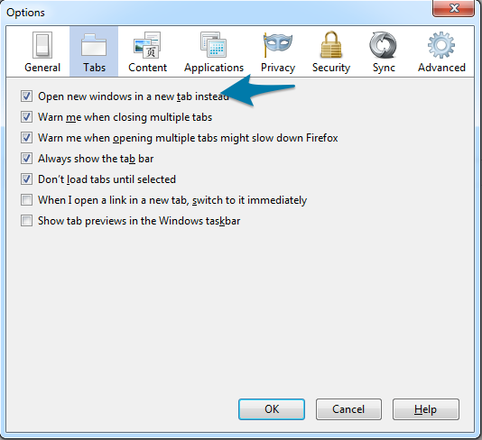

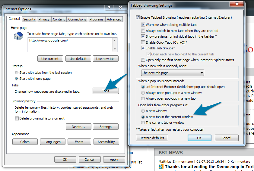

That depends on the configuration of your firefox/ie. In firefox you can define to open a new Tab instead of a new window. Same in IE. See the screenshots for the options.
index.php/fa/15441/0/
index.php/fa/15442/0/
Greetings
Stephan

Re: Scout RAP external html [message #1066368 is a reply to message #1066354] Tue, 02 July 2013 07:10 Go to previous messageGo to next message
I have both setting for IE and firefox, both still open in new window. Firefox 21 and IE 10.
