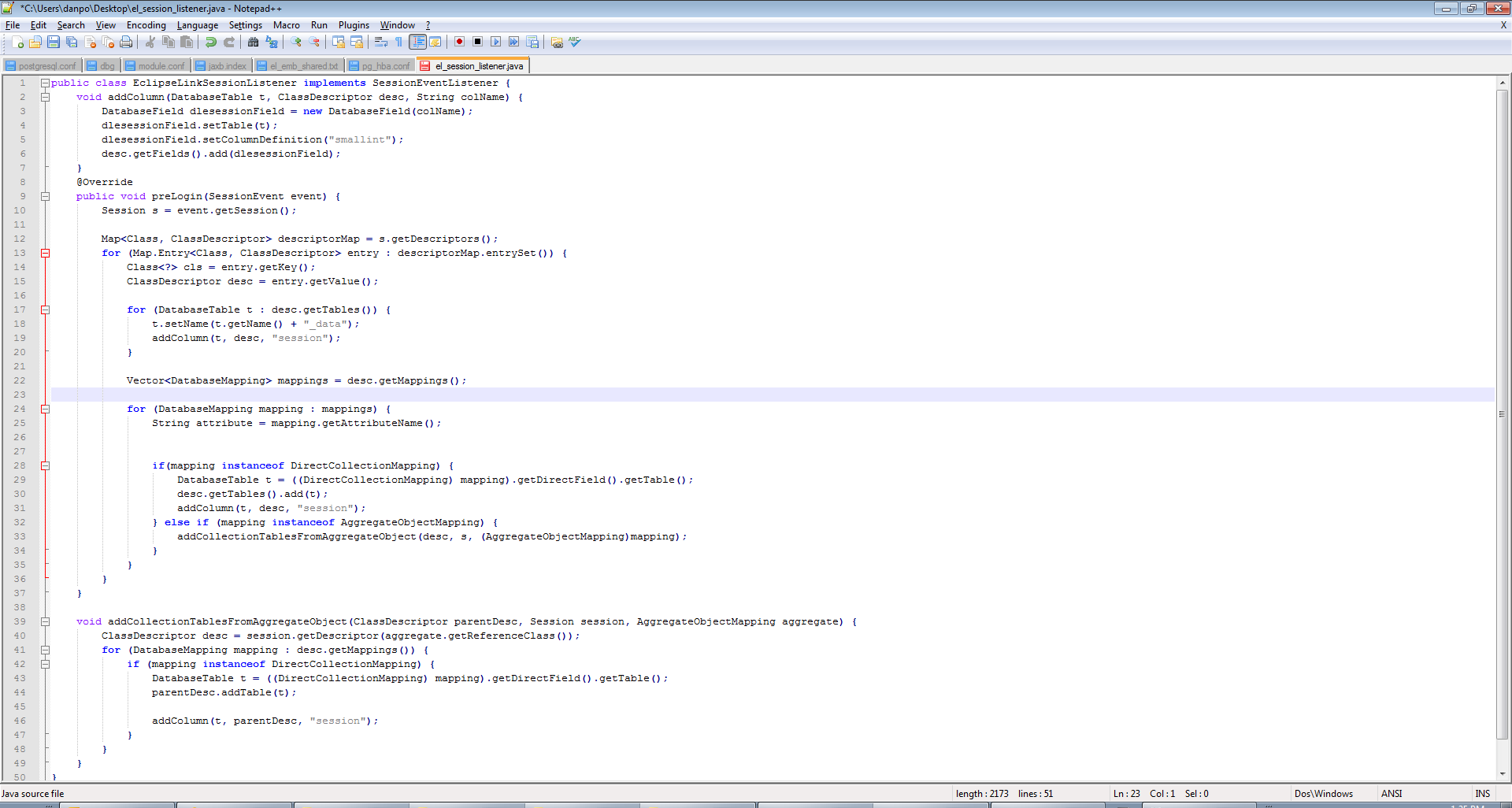

I want to replace this script by integrating somehow into EL schema generation. The easiest point i found to do it, is by using the SessionEvent listener. Using preLogin event i have the session/project and i can modify it. The problem is that i succeeded adding a field to the 'main' table, but when i try adding to the collection table, i get for some reason, except for my added column, an objId field (its my primary key of the 'main' table). Attached my code (its screenshot because my work doesn't allow posting code.. :/) I hope you understand my question..

You cannot add the table to the descriptor, this will make it thinks it maps to the table.
Using your script is probably the best solution, you may want to use the new script features of JPA 2.1 (EclipseLink 2.5).
http://wiki.eclipse.org/EclipseLink/Release/2.5/JPA21#DDL_generation
EclipseLink using the DefaultTableGenerator to generate the DDL, you may also consider using this directly, or subclassing it to have more control of DDL generation.

So it isn't possible doing it that way? it almost works... the only problem it's that for the collection table it adds another field...
What do you mean new script features? i took a look on that wiki and didn't quite got it.
