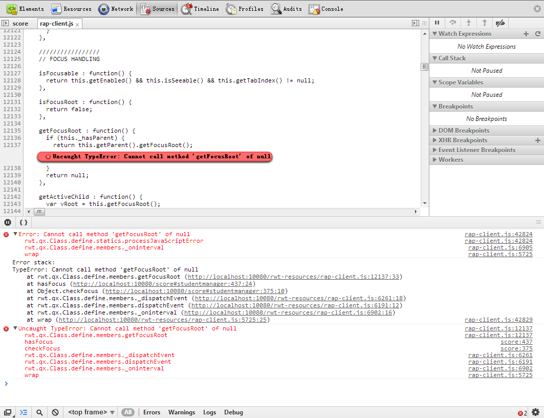

Re: error occrors sometimes when mouse moves on Text widget in ToolBar [message #1066197 is a reply to message #1066164] Mon, 01 July 2013 10:00 Go to previous messageGo to next message

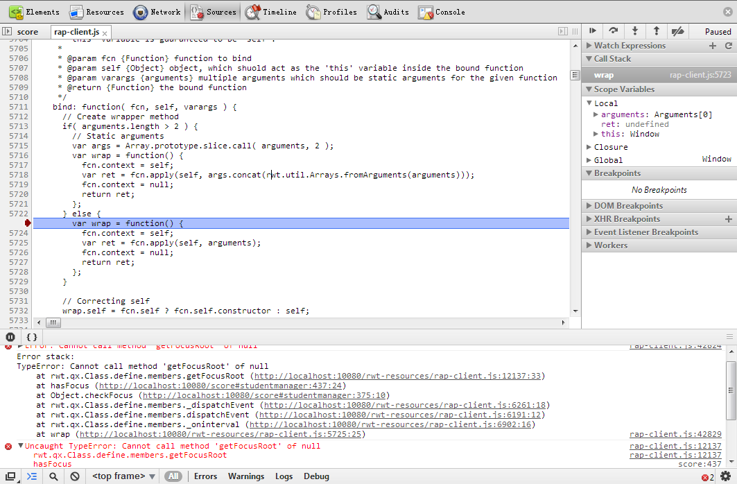

Thanks Tim for your help, I got two screenshots in Chrome,
index.php/fa/15433/0/
index.php/fa/15434/0/

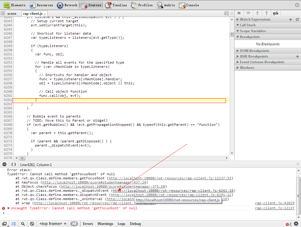

Re: error occrors sometimes when mouse moves on Text widget in ToolBar [message #1066330 is a reply to message #1066197] Tue, 02 July 2013 04:21 Go to previous messageGo to next message
Hi.
This is where the actual exception occurs (getFocusRoot), I need to see
the two calls above in the stack, hasFocus and checkFocus. I'm not sure
clicking on them in the console stack trace works, if not you can
definitely see them in the stack view while the script pauses on the
exception.

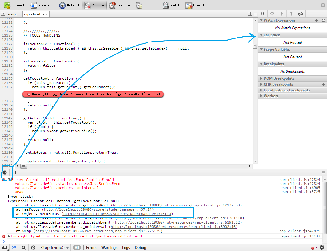

Re: error occrors sometimes when mouse moves on Text widget in ToolBar [message #1066360 is a reply to message #1066330] Tue, 02 July 2013 06:41 Go to previous messageGo to next message
Thanks Tim, as you said, I click the track view item, nothing happened excepted just a yellow flash line on the bottom in Sources window. When I click the pause button, the code displays as below screenshot.
index.php/fa/15443/0/
David
  • Attachment: pause.png
    (Size: 101.55KB, Downloaded 849 times)

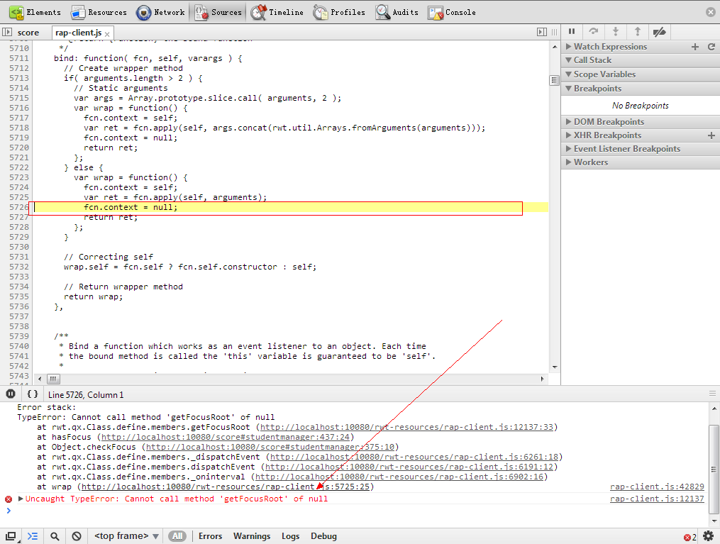

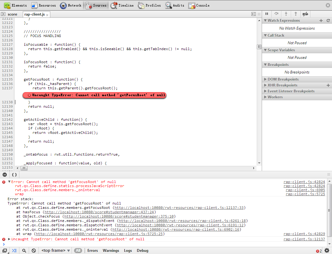

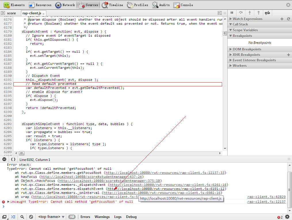

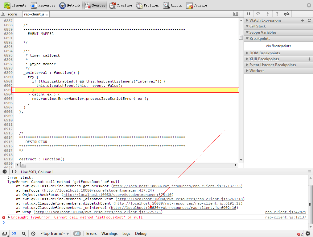

Re: error occrors sometimes when mouse moves on Text widget in ToolBar [message #1066363 is a reply to message #1066360] Tue, 02 July 2013 06:53 Go to previous messageGo to next message
when I click the stack view item (marked with an arrows), the yellow flash line is located at the line(marked with red line).
index.php/fa/15444/0/
index.php/fa/15445/0/
index.php/fa/15446/0/
index.php/fa/15447/0/
  • Attachment: 001.png
    (Size: 96.51KB, Downloaded 773 times)
  • Attachment: 002.png
    (Size: 101.95KB, Downloaded 740 times)
  • Attachment: 003.png
    (Size: 87.47KB, Downloaded 766 times)
  • Attachment: 004.png
    (Size: 94.70KB, Downloaded 778 times)
Re: error occrors sometimes when mouse moves on Text widget in ToolBar [message #1066426 is a reply to message #1066360] Tue, 02 July 2013 11:37 Go to previous messageGo to next message
That's not it either. This approach isn't going to work.
When I search for "checkFocus" and "hasFocus" it finds nothing in the
RAP core, but it does in a RAP custom widget from the Incubator
(DropDown, even in the call order from your stack trace). So unless I'm
severely mistaken, you *DO* have a custom widget in your launch config
that causes this error and should remove it from your code and launch
config to see if it fixes the issue. If so, it's a bug in that custom
widget.

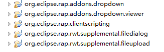

Hi Tim,
I DO NOT include any my CUSTOM WIDGETS in the launch config, but other Incubator widgets like clientscript and fileupload. Exception still ecrrors after I remove the fileupload. And the exception ONLY occurs when dropdown is used in the ToolBar widget.
index.php/fa/15457/0/
