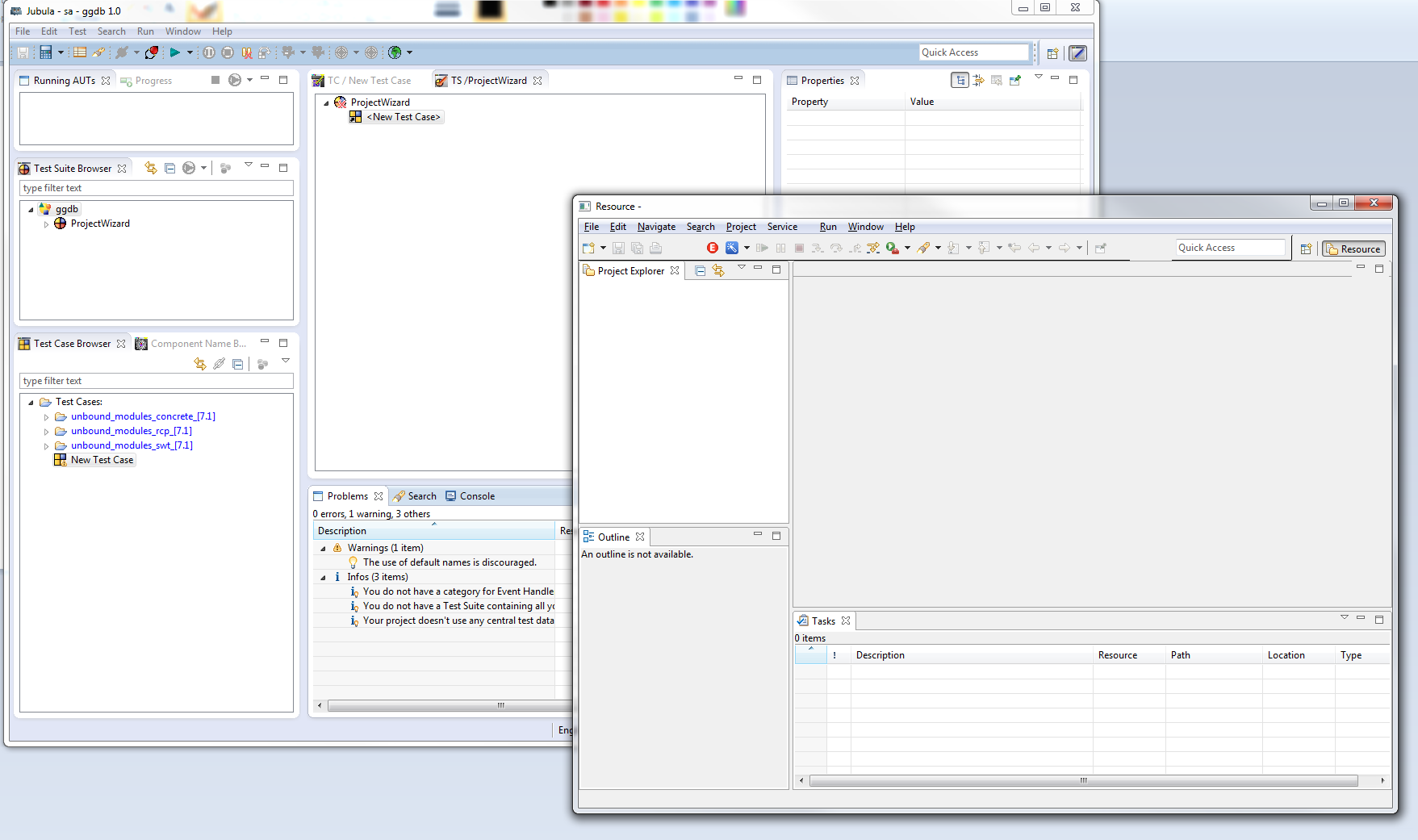

I have added the org.eclipse.jubula.rc.rcp_2.1.0.201306171048.jar to the plugin folder in my RCP directory and tried to add 'org.eclipse.jubula.rc.rcp' or 'org.eclipse.jubula.rc.rcp_2.1.0.201306171048' in config.ini. It's still no t working though - the Observation button and mapping buttons disabled and nothing is shown in Running AUT windows.
Screenshot is attached.

Re: Observation button and mapping buttons disabled [message #1066279 is a reply to message #1066259] Mon, 01 July 2013 16:39 Go to previous messageGo to next message
I was reading this post, http://www.eclipse.org/forums/index.php/m/1059144/?srch=RUNNING+AUT#msg_1059144
I am having the exact same problem except that I generated my AUT product with eclipse RCP Juno (Juno Service Release 1), not Kepler. Jubula is not able to test my product because it's somehow not compatible with products built and generated by Eclipse juno?
