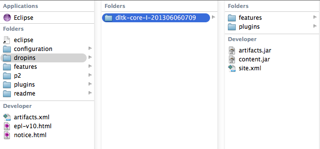

Re: PDT 3.2 - Content Assist not working on Eclipse Juno [message #1159928 is a reply to message #1065834] Mon, 28 October 2013 18:00 Go to previous messageGo to next message
Hi Toshihiro,
Thanks for the solution!
Just download DLTK 5.0, unzip it to "eclipse/dropins/"
index.php/fa/16562/0/
and it works now, perfect Surprised
