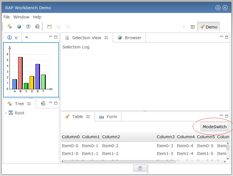

Hi Sascha,
just tried your snippet in our Workbench Demo and it's working fine for
me. See attached screenshot.

Hello Ivan,
strange.... very strange. Smile Maybe I'm missing something else in my viewpart.
Greetings,
Sascha

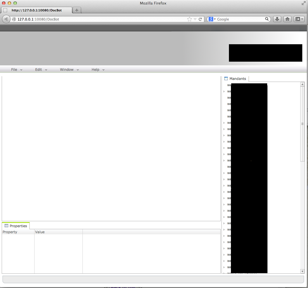

Maybe it has something to do with my theme? Cause I'm not having any close buttons in my view tabs too.
Greetings,
Sascha

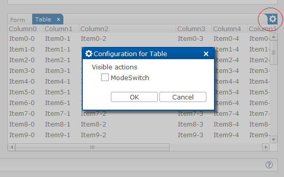

Hi Sascha,
you are not using only the theme (fancy.css + images), but the complete
design bundle (probably a copy of org.eclipse.rap.design.example). This
bundle defines a custom workbench layout and stack presentation ( see
org.eclipse.rap.design.example\META-INF\MANIFEST.MF). It seems that you
removed the
"org.eclipse.rap.internal.design.example.stacks.ConfigAction" specified
in "org.eclipse.rap.ui.stackPresentations" extension. This class enable
the configuration button in the top-right view corner (see attached
screenshot). The visibility of your actions is controlled from there.
HTH,
Ivan

Hi Ivan,
thanks for the hint. It's working now as it should work.
Greetings,
Sascha
