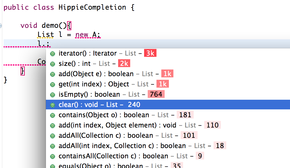

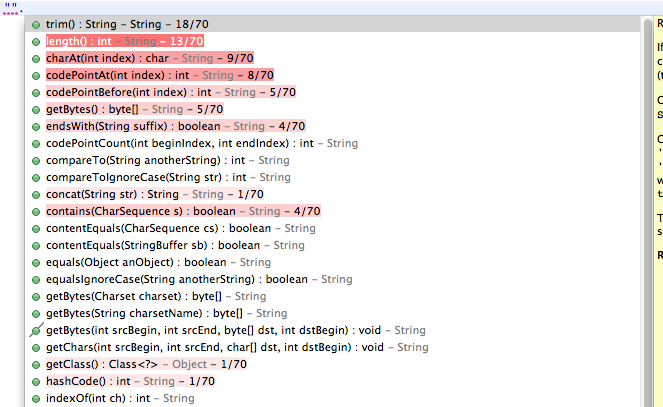

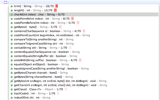

My idea is to use a color coded heatmap instead, where the color suggests how important a proposal is.
Two approaches here: 1) color the background of the entire proposal. 2) append a colored box to the proposal.
Here are two screenshots:
Keep in mind, the color scheme is just temporary.
I see some cons for both:
Option 1:
- The background color only applies to the String not to the entire line. Looks strange.
- Harder to read (can be improved with a better color scheme)
index.php/fa/15331/0/
Option 2:
- The color information gets lost, if the completion popup window is smaller than the proposal. User has to scroll to see it.
index.php/fa/15330/0/
What do you like better? Any ideas how to improve these approaches? Do you have a different idea?

I think you mixed up the screenshots. Description 2 seems to belong to the upper image.
In a first reaction, I prefer the solution from the second screen shot in which the colour information is placed next to the numbers.
Another option could be to use the colour as a background for the XXX/YYY numbers instead of using it for the entire string.

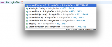

Uwe, how do you feel about the numbers at all? In a real setting we have significantly larger numbers like for StringBuffer:
index.php/fa/15339/0/
Do you find these large numbers disturbing (or maybe you like them because they tell you how many people used the methods before)?

<< Do you find these large numbers disturbing (or maybe you like them because they tell you how many people used the methods before)? >>
Hm .. I'm not sure, the large numbers are cool but on the other side it distract me.
Re: [feedback wanted] New ways to indicate proposal relevance [message #1064859 is a reply to message #1064834] Fri, 21 June 2013 08:27 Go to previous messageGo to next message
Large numbers are always good when you want to impress your manager. Wink
I think the main goal of his type of code recommendation is to prioritise the list of methods. A developer wants to see how often a method is used in comparison to the other available methods. Absolute numbers don't matter as much as relative numbers, I think. So it might be sufficient to show percentages and/or colour codes.
In addition to that, you could offer a preference setting to switch between absolute numbers and relative numbers. It could be fun to see some big absolute numbers from time to time. Smile
