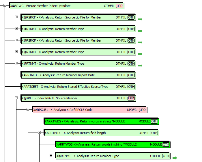

We are facing a problem, in handling a large number of Draw2d Figures, in a single Canvas. We are building a Tree of the nodes, with Connections between a parent, and a child node. The number of figures, in the canvas are of the order of 10000 (just the "Node" Figures, there are about another 10000 "Connection" figures too, that I am not counting).
I am attaching a part of one of our diagrams in Image:
index.php/fa/15286/0/
