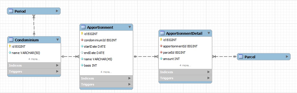

As a general principles (following guidelines I found on the Web), all my tables have a 'id' pk field and to address relationship between the tables, I have set foreign keys on the child tables. For the above generated code, here are the tables involved:
index.php/fa/15236/0/
(The post preview doesn't display the image - if it persists after submitting, check the attached file)
Has someone already encountered this issue ? I'm sure I'm doing something wrong but it is several days I'm unsuccessfully trying to figure out where it is coming from Sad

It would appear that you have encountered a bug in the Dali entity generation code. This issue is likely more prevalent on a database such as MySQL (which has some interesting table/column case dynamics dependent on the OS.) My guess is you are encountering some delimiting which ends up escaping our template code. Could you please file a bug for this here:
https://bugs.eclipse.org/bugs/enter_bug.cgi?product=Dali%20JPA%20Tools
I'm not sure if there are a lot of great workaround without switching your OS or your database vendor. It does seem a little odd that this issue hasn't been reported before, so perhaps there is more to the story. Be sure to indicate in the bug what OS the MySQL database is running on as this makes a difference in the delimiting that would take place in a generated entity. Perhaps with more information on the bug we will be able to provide a suitable workaround until Kepler SR1 comes out. Thanks for reporting.

For information, the issue first arised using a MySQL server hosted on my Synology NAS. Based on your comment, I deployed a fresh MySQL server instance (last version to date - 5.6.12) on my dev machine (Windows 8 ) but unfortunately it didn't help.
Do you think there are options I could tune to get around the problem (like changing the storage engine, the schema colletion character set, other)? All my schema is prepared using MySQL Workbench and therefore switching to another DB would be very painful :-s Any practical suggestion to move forward until this is fixed would be more than welcomed...
