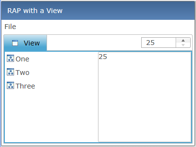

I have a strange behavior of a ControlContribution in the ToolBar of a View: The Control (e.g. a Spinner) does not keep its focus.
index.php/fa/15217/0/
The attached figure shows the example "RAP Application with a View" generated by the New Plug-in Project wizard. I just modified the Perspective so that the view has a Title and in the method createPartControl(Composite) of the View I add a Label and the ControlContribution in the ToolBar:
public void createPartControl(Composite parent) {
  int style = SWT.MULTI | SWT.H_SCROLL | SWT.V_SCROLL;
  viewer = new TableViewer(parent, style);
  viewer.setContentProvider(new ViewContentProvider());
  viewer.setLabelProvider(new ViewLabelProvider());
  viewer.setInput(getViewSite());
  label = new Label(parent, SWT.BORDER);
  label.setText("label");
  IToolBarManager manager = getViewSite().getActionBars().getToolBarManager();
  manager.add(new MyControlItem(this));
MyControlItem looks like this:
public class MyControlItem extends ControlContribution {
  View view;
  public MyControlItem (View view) {
    super("id");
    this.view = view;
  protected Control createControl(Composite parent) {
  final Spinner spinner = new Spinner(parent, SWT.BORDER);
  spinner.setMinimum( 25);
  spinner.setMaximum(400);
  spinner.setIncrement(25);
  spinner.setPageIncrement(100);
  spinner.setSelection(100);
  spinner.addListener(SWT.Traverse, new Listener() {
    public void handleEvent(Event event) {
      switch (event.detail) {
      case SWT.TRAVERSE_RETURN:
        view.setLabelText(String.valueOf(spinner.getSelection()));
  spinner.addListener(SWT.FocusOut, new Listener() {
  return spinner;
What it SHOULD do: Update the label in the view on SWT.FocusOut or on SWT.Traverse with event.detail == SWT.TRAVERSE_RETURN.
What it ACTUALLY does: Update the label every time the value of the spinner is changed.
The reason for that is that the spinner does not keep it's focus, so a focus out event occurs.
In my real application it is not a label that should be updated but an image. To minimize the traffic it should really only be updated on focus out.
In an RCP application the label/image is updated correctly.
Is it possible get the correct behavior also in the RAP?
Julia

BTW I've tested your snippet with RAP 2.1 RC3 and it's working as you
expected. Which RAP version are you using? Which browser?
Best,
Ivan

I used RAP 2.0 and just updated to RAP 2.1 RC3. This gave me the warning that I should use a newer version of Eclipse. But I'm using already the latest version that is available on the download site (eclipse-rcp-juno-SR2-win32-x86_64.zip).
I also updated the RAP tools to the nightly version. Maybe I should have used the 2.1 release.
The unwanted behavior persists, unfortunately... in several browsers: Eclipse internal, Firefox, Chrome.
Julia

Re: ControlContribution in a view's menu bar [message #1063191 is a reply to message #1063018] Wed, 12 June 2013 11:11 Go to previous messageGo to next message
Thanks, Ralf!
I could update these old style plugins Smile. One has to increase the version number, too, else the whole workspace gets messed up!
I also use now Kepler with RAP 2.1 and the war file is generated without problem (org.eclipse.equinox.servletbridge.extensionbundle is not included).
But again I get this NoSuchMethodError when trying to start the application on tomcat6:
HTTP Status 500 - Servlet execution threw an exception
type Exception report
message Servlet execution threw an exception
description The server encountered an internal error that prevented it from fulfilling this request.
exception
javax.servlet.ServletException: Servlet execution threw an exception
root cause
java.lang.NoSuchMethodError: javax.servlet.http.Cookie.setHttpOnly(Z)V
	org.eclipse.rap.rwt.internal.service.SettingStoreManager.getStoreId(SettingStoreManager.java:91)
	org.eclipse.rap.rwt.internal.service.SettingStoreManager.getStore(SettingStoreManager.java:34)
	org.eclipse.rap.rwt.RWT.getSettingStore(RWT.java:484)
	org.eclipse.rap.ui.internal.preferences.SessionPreferencesNode.internalGet(SessionPreferencesNode.java:487)
	org.eclipse.rap.ui.internal.preferences.SessionPreferencesNode.get(SessionPreferencesNode.java:196)
	org.eclipse.core.internal.preferences.PreferencesService.get(PreferencesService.java:465)
	org.eclipse.ui.preferences.ScopedPreferenceStoreCore.internalGet(ScopedPreferenceStoreCore.java:457)
	org.eclipse.ui.preferences.ScopedPreferenceStoreCore.getBoolean(ScopedPreferenceStoreCore.java:370)
	org.eclipse.ui.preferences.ScopedPreferenceStore.getBoolean(ScopedPreferenceStore.java:447)
	org.eclipse.ui.internal.UISynchronizer.<init>(UISynchronizer.java:88)
	org.eclipse.ui.internal.Workbench.runUI(Workbench.java:2548)
	org.eclipse.ui.internal.Workbench.access$5(Workbench.java:2530)
	org.eclipse.ui.internal.Workbench$5.run(Workbench.java:701)
	org.eclipse.core.databinding.observable.Realm.runWithDefault(Realm.java:332)
	org.eclipse.ui.internal.Workbench.createAndRunWorkbench(Workbench.java:684)
	org.eclipse.ui.PlatformUI.createAndRunWorkbench(PlatformUI.java:157)
	eub.rapjlzhview.Application.start(Application.java:18)
	org.eclipse.rap.ui.internal.application.EntryPointApplicationWrapper.createUI(EntryPointApplicationWrapper.java:38)
	org.eclipse.rap.rwt.internal.lifecycle.RWTLifeCycle.createUI(RWTLifeCycle.java:186)
	org.eclipse.rap.rwt.internal.lifecycle.RWTLifeCycle$UIThreadController.run(RWTLifeCycle.java:298)
	java.lang.Thread.run(Unknown Source)
	org.eclipse.rap.rwt.internal.lifecycle.UIThread.run(UIThread.java:104)
note The full stack trace of the root cause is available in the Apache Tomcat/6.0.37 logs.
All plugins are in the status active except the org.eclipse.equinox.servletbridge.extensionbundle:
osgi> ss
"Framework is launched."
id      State       Bundle
0       ACTIVE      org.eclipse.osgi_3.9.0.v20130529-1710
                    Fragments=23
1       ACTIVE      com.ibm.icu.base_50.1.1.v201304230130
2       ACTIVE      eub.jlzhinternal_1.0.0
3       ACTIVE      eub.jlzhtools_1.0.0
4       ACTIVE      eub.lib_2.0.0
5       ACTIVE      eub.lzhview_2.0.0
6       ACTIVE      eub.rapjlzhview_1.0.0.201306121638
7       ACTIVE      eub.tableeditor_3.0.0
8       ACTIVE      javax.xml_1.3.4.v201005080400
9       ACTIVE      org.apache.felix.gogo.runtime_0.10.0.v201209301036
10      ACTIVE      org.apache.felix.gogo.shell_0.10.0.v201212101605
11      ACTIVE      org.eclipse.core.commands_3.6.100.v20130515-1857
12      ACTIVE      org.eclipse.core.contenttype_3.4.200.v20130326-1255
13      ACTIVE      org.eclipse.core.databinding_1.4.1.v20130515-1857
14      ACTIVE      org.eclipse.core.databinding.observable_1.4.1.v20130515-1857
15      ACTIVE      org.eclipse.core.databinding.property_1.4.200.v20130515-1857
16      ACTIVE      org.eclipse.core.expressions_3.4.500.v20130515-1343
17      ACTIVE      org.eclipse.core.jobs_3.5.300.v20130429-1813
18      ACTIVE      org.eclipse.core.runtime_3.9.0.v20130326-1255
19      ACTIVE      org.eclipse.equinox.app_1.3.100.v20130327-1442
20      ACTIVE      org.eclipse.equinox.common_3.6.200.v20130402-1505
21      ACTIVE      org.eclipse.equinox.console_1.0.100.v20130429-0953
22      ACTIVE      org.eclipse.equinox.http.registry_1.1.300.v20130402-1529
23      RESOLVED    org.eclipse.equinox.servletbridge.extensionbundle_1.3.0
                    Master=0
24      ACTIVE      org.eclipse.equinox.http.servlet_1.1.400.v20130418-1354
25      ACTIVE      org.eclipse.equinox.http.servletbridge_1.0.300.v20130327-144
2
26      ACTIVE      org.eclipse.equinox.preferences_3.5.100.v20130422-1538
27      ACTIVE      org.eclipse.equinox.registry_3.5.300.v20130327-1442
28      ACTIVE      org.eclipse.help_3.6.0.v20130326-1254
29      ACTIVE      org.eclipse.osgi.services_3.3.100.v20130513-1956
30      ACTIVE      org.eclipse.rap.design.example_2.1.0.20130524-0811
31      ACTIVE      org.eclipse.rap.jface_2.1.0.20130506-1748
32      ACTIVE      org.eclipse.rap.jface.databinding_2.1.0.20130506-1748
33      ACTIVE      org.eclipse.rap.rwt_2.1.0.20130527-1011
34      ACTIVE      org.eclipse.rap.rwt.osgi_2.1.0.20130506-1748
35      ACTIVE      org.eclipse.rap.ui_2.1.0.20130528-1219
36      ACTIVE      org.eclipse.rap.ui.workbench_2.1.0.20130506-1748
osgi>
NoSuchMethodError sounds like incompatible java versions, but all Plugins are compiled with jre6, which is also installed on the server (which is localhost).
Any idea, what could be the problem?
Besides that, the spinner in my toolbar still does not behave correctly, unfortunately...

Re: ControlContribution in a view's menu bar [message #1063493 is a reply to message #1063222] Thu, 13 June 2013 06:05 Go to previous messageGo to next message
Dear Ivan,
Here is the test project, which shows the problem. I tested it in the Eclipse internal browser, Firefox and Chrome. My system is Windows 8 (64 bit). My Eclipse version is eclipse-rcp-kepler-RC3-win32-x86_64. The project was created with eclipse-rcp-juno-SR2-win32-x86_64 and RAP 2.0.
Thanks for investing your time!
Julia
  • Attachment: test2.zip
    (Size: 18.22KB, Downloaded 263 times)
Re: ControlContribution in a view's menu bar [message #1063497 is a reply to message #1063493] Thu, 13 June 2013 06:12 Go to previous message
... I just found the source of the problem:
in the View's setFocus() method the focus is passed to the viewer's control. Commenting this out, i.e. leaving the setFocus() method empty let the spinner behave properly!
I have to check now what consequences this has in my real application an if I can use it like that.
Thanks again and regards,
Julia
