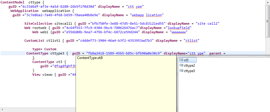

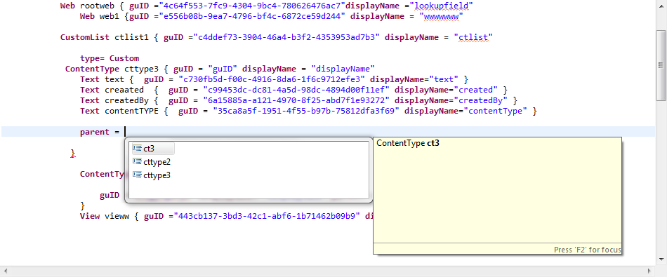

I Wrote a grammar but I have a problem with Crossreference.When I write language in the editor.
Screen1: If I define field (lookup or boolean) in the contenttype->(ownedField+=Field (ownedField+=Field)*)?
not cames ct3 in the contenttype parent's ,onlly comes cttype3 (any defined contenttype not comes)
Screen2:if I dont write any field ,comes all defined contenttype in the contenttype's parent.
not:ct3 and cttype3 in the same scope(defined in the CustomList)

	[color=red]('parent' '=' parentContentType=[ContentType|QualifiedName])?
	(ownedField+=Field (ownedField+=Field)*)?[/color]  //I have problem this line

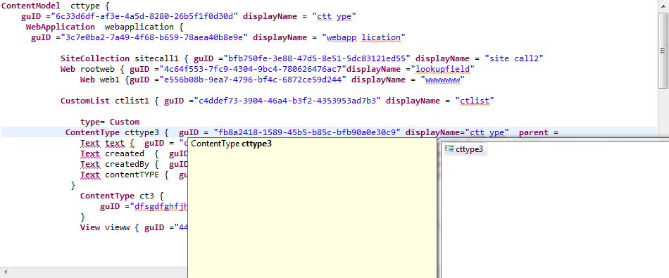

I try change ordered :
FIRSTLY :screen3 ->I defined Contenttype's parent end of the Field ,comes all contenttypes
changed grammar :
ContentType returns ContentType:
	'ContentType'
	name=ID
	(('guID' '=' guID=STRING)
	('displayName' '=' displayName=STRING )
	('description' '=' description=STRING)?
	('group' '=' group=STRING)?
	 (('parent' '=' parentContentType=[ContentType|ID])*)?)

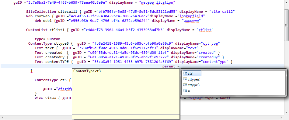

SECOND:screen4 ->if I define parent end of the defined fields,comes all contenttype,
if I defined parent before create field,comes onlly cttype3,
used unorderedgroup ,but I take warning
As a result, alternative(s) 2 were disabled for that input
Semantic predicates were present but were hidden by actions.
'ContentType'
name=ID
( (('parent' '=' parentContentType=[ContentType|ID])*)? &
(ownedField+=Field (ownedField+=Field)*)? )
I can't solved Sad please help me.How can I solved this problem in the grammar
