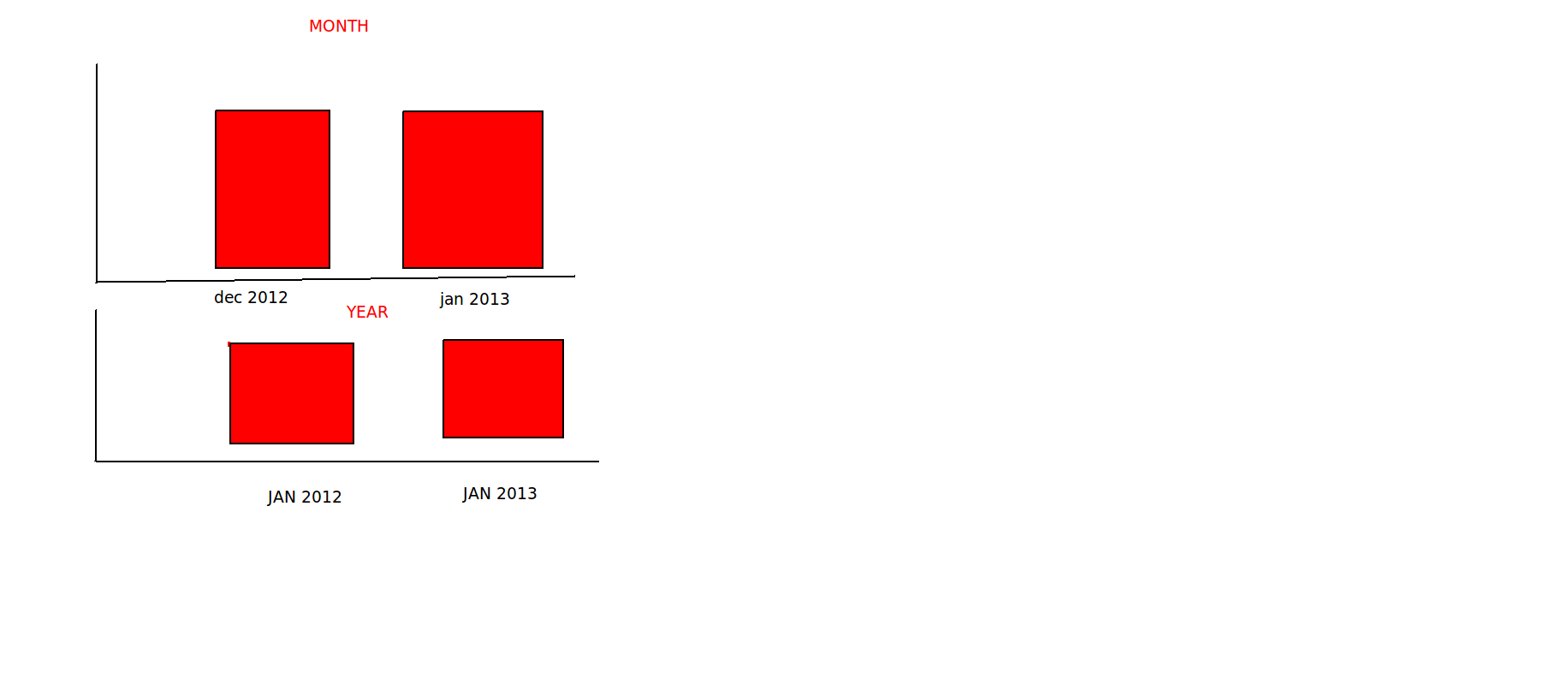

BIRT my question is when i select parameter in list box it have to compare a value in chart it have to produce a result...
for example if i am having a one list box i.e select month: jan 2013,feb 2013,mar 2013 and then another list box Period:Last month,Last year
when i select a Jan 2013 from one list box and then i wil select Last Month or Last year in another list box so result will be Jan 2013 total value and DEC 2012 total value for Last Month likewise then i will select Last Year Jan 2013 total value and Jan 2012 total value have to display....
i have attached a sample report and image for u r reference..
thank's in advance
  • Attachment: re.png
    (Size: 14.10KB, Downloaded 204 times)
