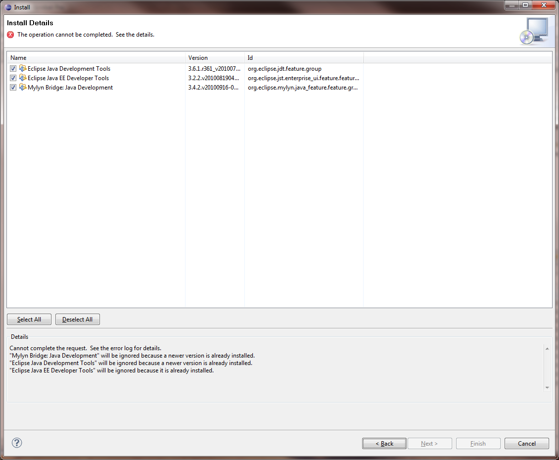

I can't seem to update
Eclipse Java Development Tools and
Eclipse Java EE Developer Tools
I can't get past the following error:
Some sites could not be found. See the error log for more detail.
HTTP Server 'Internal Error': http://dev.eclipse.org/svnroot/dsdp/org.eclipse.tm.tcf/releases/0.3.0/content.xml
HttpClient connection error response code 500.
HTTP Server 'Internal Error': http://dev.eclipse.org/svnroot/dsdp/org.eclipse.tm.tcf/releases/0.4.0/content.xml
It is Helios Service Release 2.
It seems unreasonable that I have to uninstall and reinstall Eclipse just to get this update to work correctly.

This is the info from the error log:
Cannot complete the install because of a conflicting dependency.
Software being installed: Eclipse Java Development Tools 3.7.2.v20120120-1414-7z8gFcuFMP7BW5XTz0jLTnz0l9B1 (org.eclipse.jdt.feature.group 3.7.2.v20120120-1414-7z8gFcuFMP7BW5XTz0jLTnz0l9B1)
Software currently installed: Eclipse IDE for PHP Developers 1.3.2.20110301-1807 (epp.package.php 1.3.2.20110301-1807)
Only one of the following can be installed at once:
Eclipse IDE UI Application 1.0.201.M20100707-0800 (org.eclipse.ui.ide.application 1.0.201.M20100707-0800)
Eclipse IDE UI Application 1.0.200.I20100601-0800 (org.eclipse.ui.ide.application 1.0.200.I20100601-0800)
Eclipse IDE UI Application 1.0.300.I20110306-2000 (org.eclipse.ui.ide.application 1.0.300.I20110306-2000)
Cannot satisfy dependency:
From: Eclipse IDE for PHP Developers 1.3.2.20110301-1807 (epp.package.php 1.3.2.20110301-1807)
To: org.eclipse.epp.package.php.feature.feature.group [1.3.2.20110301-1807]
From: EPP PHP Feature 1.3.2.20110301-1807 (org.eclipse.epp.package.php.feature.feature.group 1.3.2.20110301-1807)
To: org.eclipse.platform.feature.group [3.6.2.r362_v20110210-9gF78Gs1FrIGnHDHWkEcopoN8AmxeZflGDGKQi]
From: Eclipse Java Development Tools 3.7.2.v20120120-1414-7z8gFcuFMP7BW5XTz0jLTnz0l9B1 (org.eclipse.jdt.feature.group 3.7.2.v20120120-1414-7z8gFcuFMP7BW5XTz0jLTnz0l9B1)
To: org.eclipse.platform.feature.group 3.7.2
From: Eclipse Platform 3.6.2.r362_v20110210-9gF78Gs1FrIGnHDHWkEcopoN8AmxeZflGDGKQi (org.eclipse.platform.feature.group 3.6.2.r362_v20110210-9gF78Gs1FrIGnHDHWkEcopoN8AmxeZflGDGKQi)
To: org.eclipse.ui.ide.application [1.0.201.M20100707-0800]
From: Eclipse Platform 3.7.2.v20120207-1839-9gF7UHPDFxGjd-PqDr2jX_4yKaumkoHTz04_q-q (org.eclipse.platform.feature.group 3.7.2.v20120207-1839-9gF7UHPDFxGjd-PqDr2jX_4yKaumkoHTz04_q-q)
To: org.eclipse.ui.ide.application [1.0.300.I20110306-2000]

Re: How to fix updates [message #1062242 is a reply to message #1062108] Thu, 06 June 2013 12:27 Go to previous messageGo to next message
My interpretation is:
You have PHP support which requires platform 3.6.2 (Helios)
You're trying to install JDT 3.7.2 which requires platform 3.7.2 (Indigo)
=> hence the conflicting dependencies.
It might work OK if you at the same time update your PHP tooling (i.e., Eclipse IDE for PHP Developers) to the Indigo version.
Re: How to fix updates [message #1062252 is a reply to message #1062242] Thu, 06 June 2013 13:55 Go to previous messageGo to next message
I know why it's failing. I want to know how to change the sites that it uses to update and what the best sites to use are.
Re: How to fix updates [message #1062258 is a reply to message #1062108] Thu, 06 June 2013 15:18 Go to previous messageGo to next message
I tried your method. It does not work.

I'm using Helios.
Also, no matter which one I use, it says the latest version is already installed.
[Updated on: Fri, 07 June 2013 02:41] by Moderator
