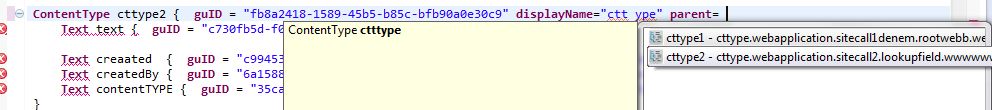

Hi all ,
When I enter ctrl +space ,all usable objects get.I want to customize this window.Which class is used for this.such as I load screenshot Contentype parent: cttype2 must not get in this .When I enter ctrl+space ,gets onlly cttype1 and then user will change cttype1.How can I do this.and Which class is used for this problem ?
Best Regards
  • Attachment: removeown.png
    (Size: 23.16KB, Downloaded 137 times)
Re: CTRL+SPCACE for Cross Reference [message #1061602 is a reply to message #1061598] Mon, 03 June 2013 04:52 Go to previous messageGo to next message
The class is youdslproposalprovider. It calls look up cross
reference. This allows a filter predicate

Re: CTRL+SPCACE for Cross Reference [message #1061727 is a reply to message #1061720] Mon, 03 June 2013 11:32 Go to previous messageGo to next message
Sorry this looks you want to customize scoping and not only the
proposals. As always I find it difficult to get your point.
