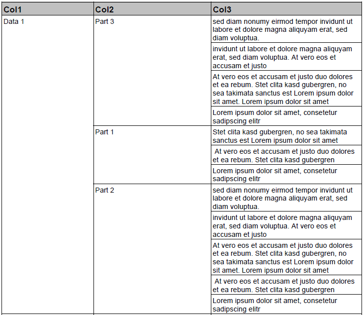

I started looking into data sets. What I need is a table containing 3 columns (like in the picture I attached). But the rows aren't normal string arrays. One element in the first row can belong to a list of elements in the second. It's the same with elements in the second and third column. Is that even possible to create as a data set? I don't want to create a new row with empty columns.

  • Attachment: Table.PNG

No, you wouldn't want to create a dataSet with empty columns. What you'd do would be to make a dataSet like:
Col1 | Col2 | Col3
Data1 | Part3 | Detail1
Data1 | Part3 | Detail2
Data1 | Part1 | Detail1
etc.
Then, you'd use grouping in your table to get what you're wanting for the layout.

Sorry for answering that late, I have been sick for over a week. I started playing around with data sets and groups though, but couldn't get the result I was hoping for. Is there a way to create the layout I posted as a picture before? I don't want the group header to be in a separate line and I don't want the data, that is used for grouping, to be repeated in each line.
Grouping in general worked, only the layout isn't the way I want it to be. Thank you for your help!
Re: PDF export of report with grid doesn't work correctly if cell is broken across two pages [message #1071392 is a reply to message #1070528] Fri, 19 July 2013 21:32 Go to previous messageGo to next message
You can use the drop on the group cell to get it to drop down to the detail level. To set this, choose the cell that the group data element is in and set the drop property on the general tab of the property editor to "detail".
