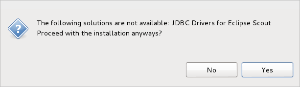

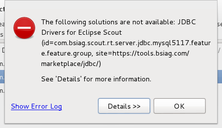

is there again a problem with the Webserver again? I tried with one PC with Indigo and another PC with Keppler to install the JDBC drivers.
I always get the attached message. (The following solutions are not available: JDBC Drivers for Eclipse Scout)

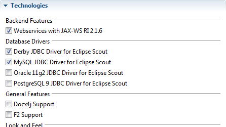

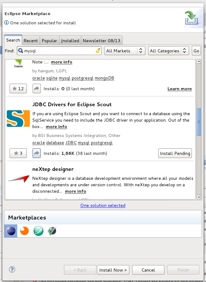

I checked the MySql box in the SDK (attached pic). But as i could not connect to my MySQL database - i even made a new hello world project with an "SELECT 'hello' INTO ..." statement and also failed. So I thought i need to install the jdbc drivers, so i tried it with the marketplace (second pic) - there i got the errors.
Or is everything Ok, as long as I check the "Mysql" checkbox as in the first pic?

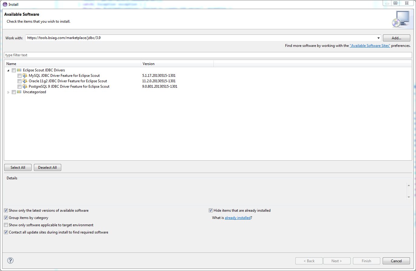

What happens if you click on "Help" -> "Install New Software..." on your Eclipse IDE and enter the URL: https://tools.bsiag.com/marketplace/jdbc/3.9 as shown in the picture?
index.php/fa/16283/0/
Are you able to see the MySQL, PostgreSQL and Oracle features?

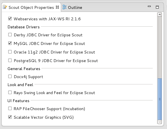

When you have the MySQL support successfully installed in you application:
index.php/fa/16284/0/

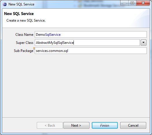

When you create a new SQL Service, you will be able to pick AbstractMySqlSqlService as Super class:
index.php/fa/16285/0/
This will set the JdbcDriverName to com.mysql.jdbc.Driver.
