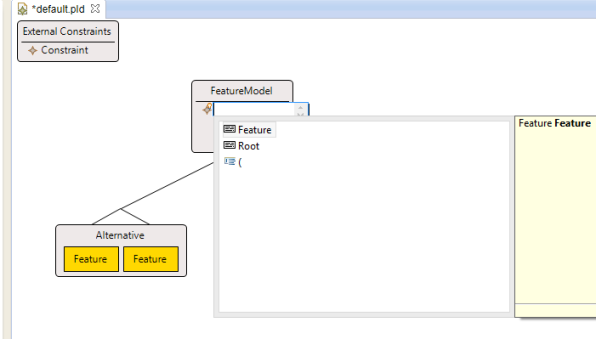

Ok, I've got a GMF Editor where a node implement an IXtextAwareEditPart in order to make use of a Xtext grammar. The Xtext grammar acces specific elements of this diagram (see immage).
index.php/fa/15141/0/
The problem is when I add new elements to the gmf diagram, it needs to be saved - otherwise the newly elements aren't visible in the xtext grammar (so the save mechanism of the gmf editor start the resource description mechanism of xtext). This behaviour is what I would like to change.
Inside my GMF project I know the point, when an update of the resource description has to be happen. The problem is that I don't know how to tell my Xtext project to do this.
Hopefully you understand my use case, so maybe the description strategy isn't the right way for this?
