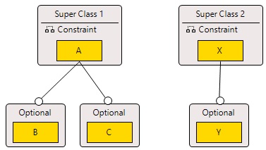

I've a special use case and not sure if it's possible.
To clarify the initial situtation, I've attached an image:
index.php/fa/15028/0/
As you can see, it's possible to have different super classes. A super class can be extended by a constraint, which should be described by a xtext grammar. What I now want is that when I add a constraint to super class 1, only nodes A,B and C should be able to refer.
At the moment also X and Y would be scoped, cause the resource description searches the whole Resource.
I've no idea if it would be possible to acces the current used node of GMF or if there is another solution. Can anyone give a hint?

You're right about the validation aspect, but then a user would see all nodes which is not what I want. A Validation can also be implemented, but what I want is a filtered list which shows the user only valid entries. But the problem here is the interaction with gmf.
