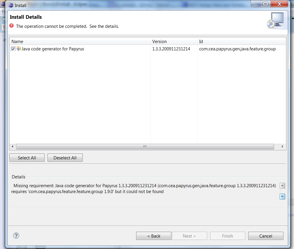

This seemed to work fine. I could see a number of extensions including three kinds of code generation. I selected Java and tried to install and got the error message shown in the attached PNG file:
"Missing requirement: Java code generator for Papyrus 1.3.3.200911231214 (com.cea.papyrus.gen.java.feature.group 1.3.3.200911231214) requires 'com.cea.papyrus.feature.feature.group 1.9.0' but it could not be found"
I also tried to install "Required Dependency" and got this error message:
"Missing requirement: Acceleo integration plugin for Papyrus 1.2.0 (com.cea.papyrus.integration.acceleo.feature.group 1.2.0) requires 'com.cea.papyrus.feature.feature.group 1.9.0' but it could not be found"

Re: Java Code Generation [message #1059734 is a reply to message #1059491] Tue, 21 May 2013 09:01 Go to previous messageGo to next message
Hi David,
Everything from papyrusuml.org/Papyrus 1.12 is deprecated and unmaintained (For about 4 years now), since Papyrus has migrated and is now an Eclipse Project: http://www.eclipse.org/papyrus
I think the Java code generation plug-ins will be back in Papyrus 0.10, in June 2013 (Eclipse Kepler).
Camille
