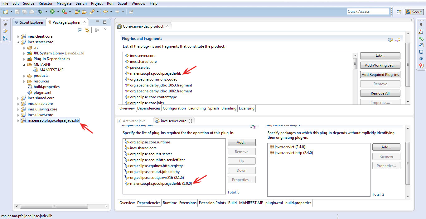

I've added a plugin that contains some libraries;
then added it to the server manifest in the required plugins section.
I also added this plugin to the server product dependencies by pressing "add required plugins".

(see Attachment Steps.jpg)

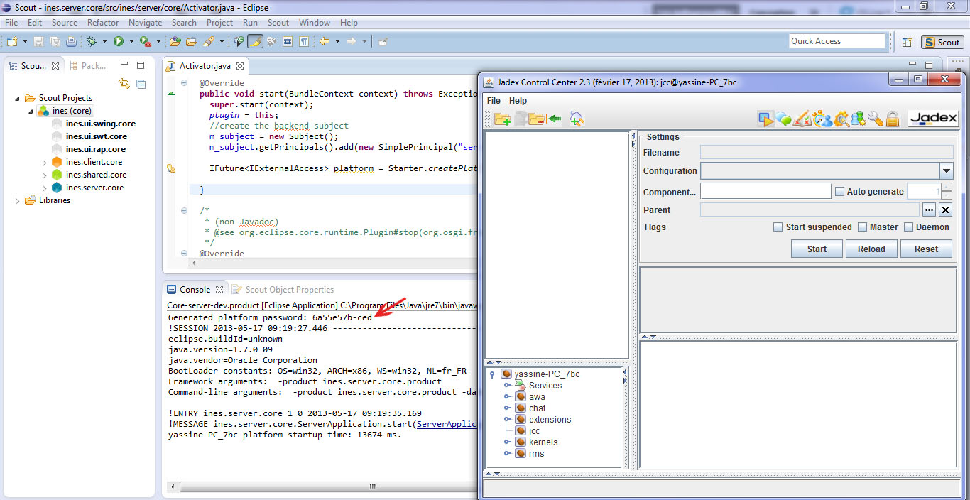

When I launch the server product for the first time it works perfectly (see Attachment below Launch_firstTime.jpg).
