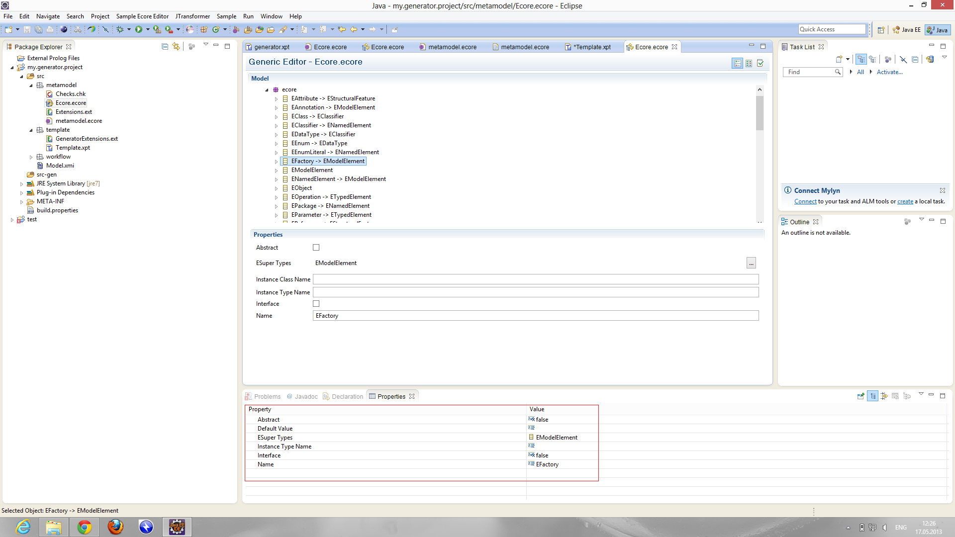

I am beginner in modeling and modeling transformation ,Working with ecore.ecore trying to do some transformation using xpand language ,I could naviagte and access elements of ecore using eclass , eallattributes , eallreferences ,ealloperations ....etc Syntax ,the question is when I click on any eclass , I have some properties that are not part of the structure of eclass , like abstract , default value , supertype ....etc attached picture to show what I mean, is there any code in xpand can enumerate these properties so I can keep all information in the transformation process.

You need to look a little harder. Everything you list is part of the
structure of an EClass. What makes you think it isn't?

Actually what make me think like this is that when I tried to get all attributes of eclass for example using eallattribute , I got all the attributes of the eclass and attributes of all of its super types ,but non of these properties are included .
if they are not attributes what they are actually are in the structure ?
could you please guide me where exactly i should look a little harder Smile as I read the whole specification of EMF ?
