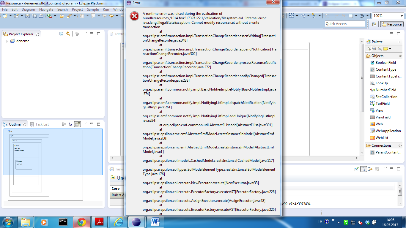

Hi all,
When i write this validation to my model;
	constraint doldur {
		guard : self.satisfies('IllegalCharactersForName')
		check {
			if(self.ownedField.select(f | f.name = "Text").size() <> 1){
				var text = new TextField;
				text.name = "Text";
				text.displayName = "Text";
				self.ownedField.add(text);
			if(self.ownedField.excludes(text)){
					return false;
			return true;
		message : 'laaaa'
i always get error (atached picture and txt file shows error)
But i need to create element from validation so how can i do this
anyone can help me ?

the check constraint of an EVL expression is there to check the model element as it is. I think what you should do is to offer a quick fix via evl. Maybe there you do not have a read only transaction.
Ralph
