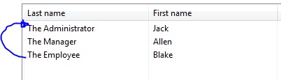

Hi all,
I try to implement drag-drop function on AbstractTableField, for this reason I follow this tutorial : http://wiki.eclipse.org/Scout/HowTo/3.9/Drag_and_drop_support
This implementation works fine, now I need to understand how to get the position of the drop to insert the moved item, because my goal is to move to a specific line in a new position in the table (see image below).
index.php/fa/17296/0/
Is it possible do somethings of this? And how?
Thanks a lot for any help
  • Attachment: Table.jpg
    (Size: 11.72KB, Downloaded 445 times)
Re: Drag & Drop issue ? [message #1234101 is a reply to message #1234093] Tue, 21 January 2014 03:39 Go to previous messageGo to next message
Hi marco,
correct me if I am wrong: What you want to know is on which position the dragged item currently is (is it over element "The Administrator", is it over element "The Manager"), correct?
If so, there is a Bug related to this: Bug 416818. Once this bug is resolved you will be able to get exactly this information.
Matthias
[Updated on: Tue, 21 January 2014 03:40] by Moderator
Re: Drag & Drop issue ? [message #1234104 is a reply to message #1234101] Tue, 21 January 2014 03:42 Go to previous message
Yes correct, is what I want to know.
