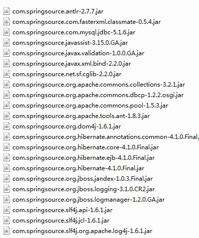

I want to user com.springsource.org.hibernate.-4.1.0.Final.jar in virgo. When I put com.springsource.org.hibernate.-4.1.0.Final.jar and its' required bundles in repository/usr before starting virgo server, the virgo server cannot be start. But if i didn't put these bundles in usr , virgo server start normally. Why is that?

I have resolved the problem, add to Virgo\configuration\org.eclipse.equinox.simpleconfigurator\bundles.info a line "com.springsource.org.jboss.logging,3.1.0.CR2,repository/usr/com.springsource.org.jboss.logging-3.1.0.CR2.jar,4,false", the server can start normally. But I don't know why. Can any one explain this ? Thanks !
