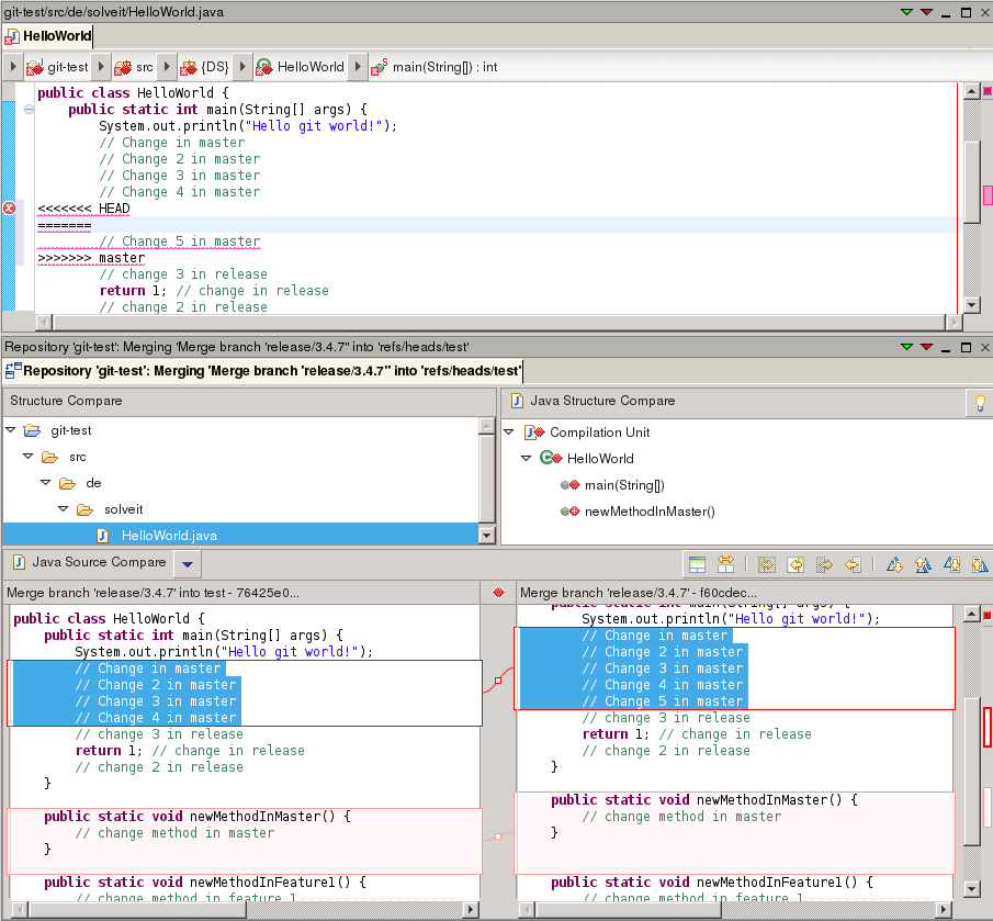

I have merged a branch with command line cgit (because EGit couldn't do it) and the file with the merge conflict looks very clean. But when I raise the Merge Tool to resolve the conflict it has a different view of the conflicts that should be resolved.
index.php/fa/14797/0/
Is it possible to configure the Merge Tool to show the conflicts according to the textual representation?

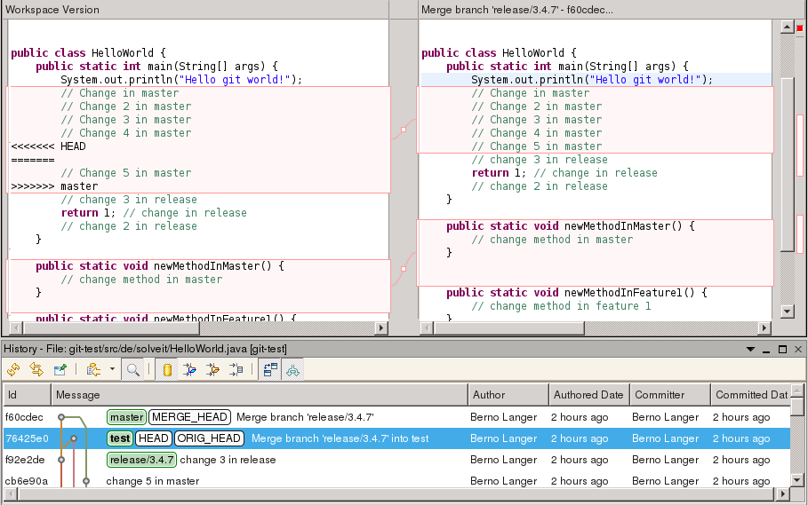

Re: Merge Tool [message #1058571 is a reply to message #1058545] Tue, 14 May 2013 09:39 Go to previous messageGo to next message
Thanks, but that doesn't help very much ...
index.php/fa/14827/0/
I would expect just the single line "// Change 5 in master" to be highlighted on the right hand side, so I could copy it in place.
Re: Merge Tool [message #1060209 is a reply to message #1058571] Thu, 23 May 2013 10:09 Go to previous messageGo to next message
The merge tool does not care about the merge done by git. It uses a diff calculation done by eclipse itself.
My rule of thump is:
- Edit the file merged by git directly if git can merge most of the content and leaves only some conflicts
- User the eclipse merge tool if there are many conflicts (choosing the HEAD version on the left hand side)
Re: Merge Tool [message #1718433 is a reply to message #1058514] Wed, 23 December 2015 10:44 Go to previous message
