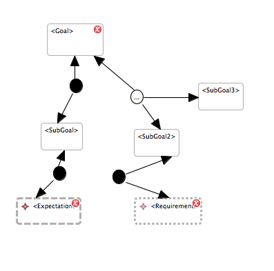

The codes seems correct, but the following mistakes arise: Please see Figure 1.
(a) Although the Root Goal (<Goal>) has been refined into subgoals and then into leaf goals an error sign still appears in it, See Figure 1.
(b) There is no error sign on the SubGoal (<SubGoal3>), even though it has not been refined into leaf goal.

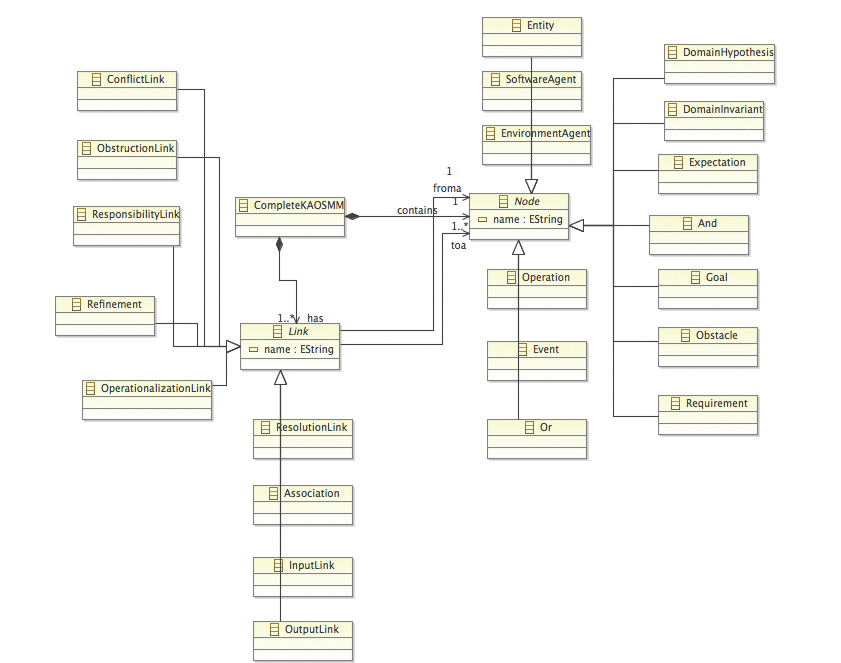

As shown in Figure 1, Goals do not go directly to leaf goals, in most cases they go through the AND/OR nodes (small circular hollow or solid figures, in Figure 1) to subgoals, and then to leaf goals ( Requirement, Expectation, DomainHypothesis, and DomainInvariant). I think I need to find a way to define a constraint that can specify that Goal and Subgoals go through the AND/OR nodes. this is very challenging to me. In the Meta-Model I used to generate the Graphic Editor (See attached as EuGENiaModel), all nodes including Goal, SubGoal, Requirement, Expectation, DomainInvariant, and DomainHypothesis inherit from one super-class called Node.
