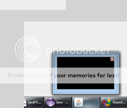

I followed Tutorial4 here: http://www.efxclipse.org/trac/wiki/Tutorial4
to create a JavaFx Aplication
I Added 1 Trimmed Window to the Aplication.e4xmi
Problem:
Indeed, when I launch the product - the applicaiton starts, the preview in the superbar show a window, see pic
http://i520.photobucket.com/albums/w327/schajtan/2013-05-08_00-40-15_zpsad39fc8a.png
But when I click on the application in the superbar - nothing happens. The window does not show up.
OS:
Wndows 7 X64
Java 1.7.0_21-b11 X64
Re: Eclipse4 with JavaFx using efxClipse [message #1053861 is a reply to message #1053860] Tue, 07 May 2013 18:51 Go to previous messageGo to next message
The X,Y and width/height of the created window get some default value which is inconsistent with the fx renderers. Use 10,10 for x,y and e.g. 300, 500 for w/h.

Re: Eclipse4 with JavaFx using efxClipse [message #1060696 is a reply to message #1060583] Mon, 27 May 2013 18:00 Go to previous messageGo to next message
I have the same problem, someone can help us?

So some meta information might help to better understand your problem.
a) what version of JavaFX and e(fx)clipse are you using
b) do you also see the window in the preview but not on screen?
c) did you update the values in the TrimmedWindow
d) did you make sure that the launch config clears your workspace from
a previous launch?
The best way we can help tracking down your problem is that you are
working against our git-master and nightly build which is fairly stable
already:
The process looks like this:
* download the latest stable 4.3 build from
http://download.eclipse.org/eclipse/downloads/
* add the following update-site
http://downloads.efxclipse.org/eclipse.org/p2-repos/ide/nightly/ via
"Install New Software" and install e(fx)clipse - IDE - Kepler
* create a target platform pointing it to
http://downloads.efxclipse.org/eclipse.org/p2-repos/runtime/nightly/ and
*uncheck "Include required software"*
* generate a new application using the wizard
The latest build already has the fix for
https://bugs.eclipse.org/bugs/show_bug.cgi?id=409112
Tom
Re: Eclipse4 with JavaFx using efxClipse [message #1060837 is a reply to message #1060829] Tue, 28 May 2013 11:03 Go to previous messageGo to next message
Thank you very much! It was because of d) and with the clearPersistedState flag it worked.
