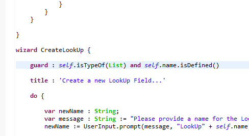

Hi all,
i make wizards for my metamodel but i see problem on illegal names.
My metamodel Hava class with name = 'List' and on EWL dont recognize its type. it see
this a built-in type. So how can i state this is my metamodel type.
(Sample scenario on attached Picture)

no its not work i use '' and then `` but not work my ewl is;

i tried but not working when i use content!List i have;
no viable alternative at input ! error
when i use 'content!List' not work again
