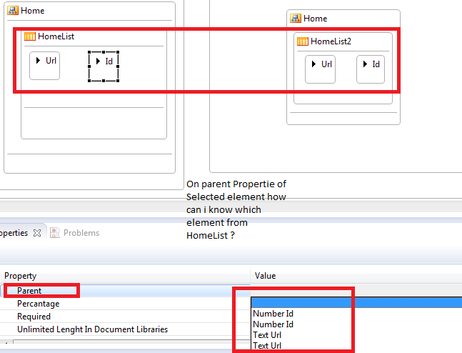

Hi all,
I need qualified name on reference labels but don't know how can i implement this
feature anyone can help me to do ?
Sample scenario is on attached picture

Re: Qualified names on referance labels [message #1059101 is a reply to message #1058987] Thu, 16 May 2013 13:20 Go to previous messageGo to next message
i cant do this it works only labels i think. But i need to show instances name as
qualified name on properties section of diagram. So i try another way, i change
the emf model getXXX(); method but when this method activated my element names change
too because when i save my diagram, Diagram thinks I changed the name of the model
instance. So if i can do this with expression label way, i think it works same as
another way too.
(on attached image u can see properties section. Its in the lower left of picture)

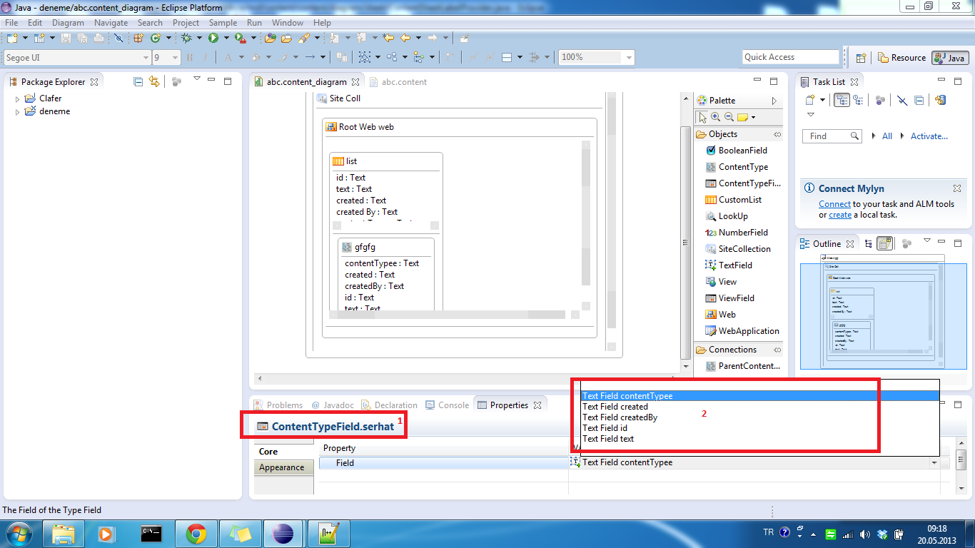

Re: Qualified names on referance labels [message #1059505 is a reply to message #1059425] Mon, 20 May 2013 02:21 Go to previous messageGo to next message
(on attached picture i explain where i need to qualified name.)
When i write this code to ContentSheetLabelProvider;
public String getText(Object element) {
		element = unwrap(element);
		if (element instanceof ContentNavigatorGroup) {
			return ((ContentNavigatorGroup) element).getGroupName() + ".serhat";
		IElementType etype = getElementType(getView(element));
		return etype == null ? "" : etype.getDisplayName() + ".serhat";
I get attached picture. But i need changed name on 2. section (on Attache picture you can see 2. section)
regards
