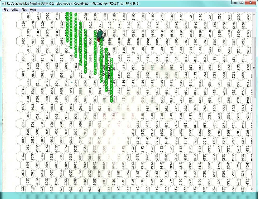

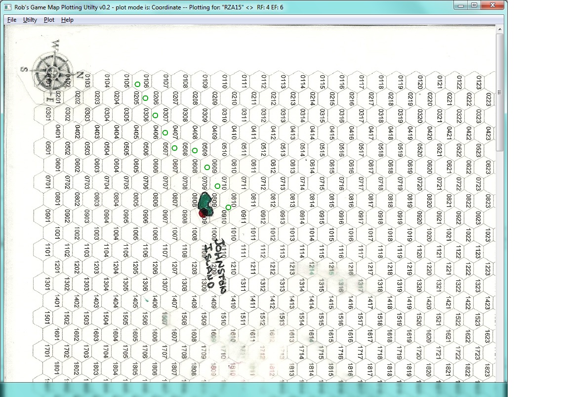

I am writing an application which loads .jpg files as images and then allows users to place "marks" on the image. I'm using code similar to that of snipped #48. When I re-size the image the marks are retained. However, when I scroll the screen, the marks (small green circles) are "smeared across the image. Resizing again will restore the image and the marks to the "correct" state. I have attached screen shots to illustrate, the first one is what the file looks like with the green circles,
index.php/fa/14655/0/
the second one shows what happens when I scroll the screen.

I looked at the javadoc for the Scroll event and one section of the description for scroll event stood out as the probable cause of the code not behaving as I want. Either that or I just don't understand the implication of what it says:
" ... In addition, all outstanding paint events are flushed before the source area is copied to ensure that the contents of the canvas are drawn correctly. "
The actual code which redraws the green circles is in the paint event handler.
So it seems like if the javadoc description was accurate it would finish scrolling before it reapplied my green circles. But obviously it's redrawing them at very small increments as the scrolling is taking place.
Any ideas would be appreciated.
And I'm using SWT 3.7.2 64 bit, on Windows 7 64 bit, in Indigo 3.7.2.
