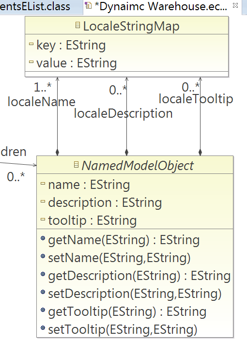

I have implemented a reference to a class that I've assigned an instance class name of java.util.Map$Entry, thus using it as an EMap. When I start my editor and run through the wizard it instantiates the model and assigns the root object to the xml serialization object. In doing so it iterates through a tree of all the contents of the model from the root object. This is in the method ResourceImpl.attached( EObject ). The code progresses down to EContentsEList.hasNext() where the following code is called.

Re: Class Cast exception thrown for an EMap during model instantiation [message #1053548 is a reply to message #1053457] Mon, 06 May 2013 09:21 Go to previous messageGo to next message
Hi Ed,
Yes, it's a multi-valued containment. I've attached a screenshot of the model objects. LocaleStringMap has an instance class name of java.util.Map$Entry, so the three references are implemented as EMaps.
The three references are initialized as follows:
protected NamedModelObjectImpl() {
		super();
		localeName = new BasicEMap<String,String>();
		localeDescription = new BasicEMap<String,String>();
		localeTooltip = new BasicEMap<String,String>();
Thanks for your help.
Cheers,
Greg
Re: Class Cast exception thrown for an EMap during model instantiation [message #1053563 is a reply to message #1053548] Mon, 06 May 2013 10:32 Go to previous messageGo to next message
Greg,
Comments below.
On 06/05/2013 3:21 PM, Greg Mising name wrote:
> Hi Ed,
> super();
You hand wrote this? Generated implementations would use EcoreEMap, so
this doesn't look generated.
> Cheers,
> Greg
Re: Class Cast exception thrown for an EMap during model instantiation [message #1053601 is a reply to message #1053563] Mon, 06 May 2013 12:55 Go to previous message
Ah, now I see my mistake. The hash maps are initialized in the get methods. Thanks. That fixed the problem.
