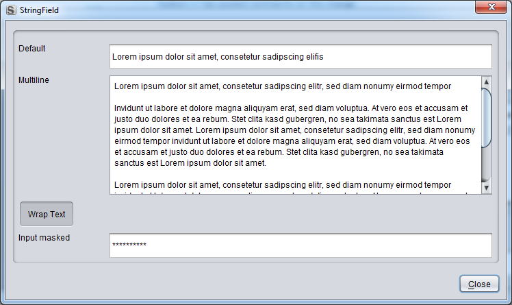

It looks like the default text field height is too small. See the picture. The letters with decender height (j,g,..) have not enough space.
index.php/fa/14636/0/
It there a way to change the default height setting?

You can control the height of the fields in a scout form by overriding a method in your swing environment:
<your app>.ui.swing.SwingEnvironment:
public class SwingEnvironment extends org.eclipse.scout.rt.ui.swing.DefaultSwingEnvironment {
  public int getFormRowHeight() {
    return 40;
index.php/fa/14667/0/
For other properties (font...) you can take control of the LookAndFeel properties (have a look at javax.swing.plaf.basic.BasicLookAndFeel in the Swing code).
