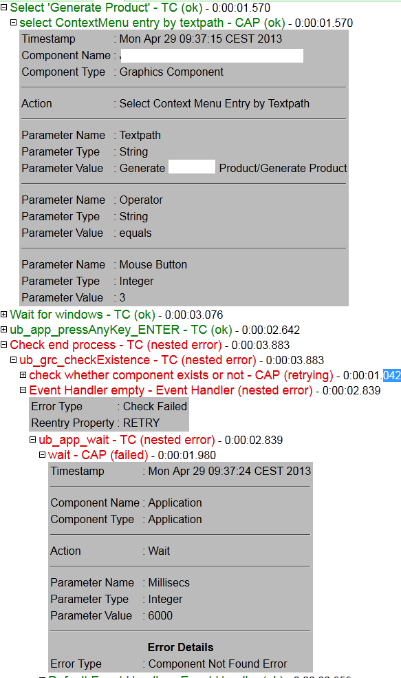

We have a generate product feature who's running an eclipse job who itself run the product export standard eclipse job.
We're wondering if the error comes from there, so we are testing if it is the case by having only one job running at a time.
After launching this feature, we periodically check the progress view to check if it is finished.
This is handled by an event handler with a wait command.
As you can see, in the middle of the wait we have a "Component not found" error.
Note that we had the same problem even without the event handler and with just a wait command with a long time so the problem really is from the "export product" feature. It worked as a charm when we removed the launching of this job.
