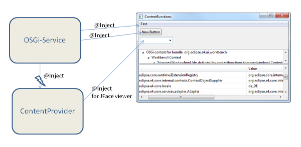

Re: Dependency Injection outside Application Model [message #1076412 is a reply to message #1052417] Wed, 31 July 2013 07:02 Go to previous message
I faced a similar problem:
index.php/fa/15786/0/
Transfered my POJO in a OSGi-Service (tutorials at vogella.de). @Inject ignored in bundle with contentProvider (outside application model)
You can solve this by:
//Get bundle of this class
Bundle bundle = FrameworkUtil.getBundle(this.getClass());
//Get context of this bundle
BundleContext bundleCntxt = bundle.getBundleContext();
//Alternative 1:
IEclipseContext context = EclipseContextFactory.getServiceContext(bundleCntxt);
yourOSGI-Service-Object object = (Type-cast)context.get("name");
//Alternative 2:
ServiceReference<?> serviceReference = bundleCntxt.getServiceReference("name");
yourOSGI-Service-Object object = (Type-cast) bundleCntxt.getService(serviceReference);
But isn't there a better solution so that I can use @Inject @Named("name")?
